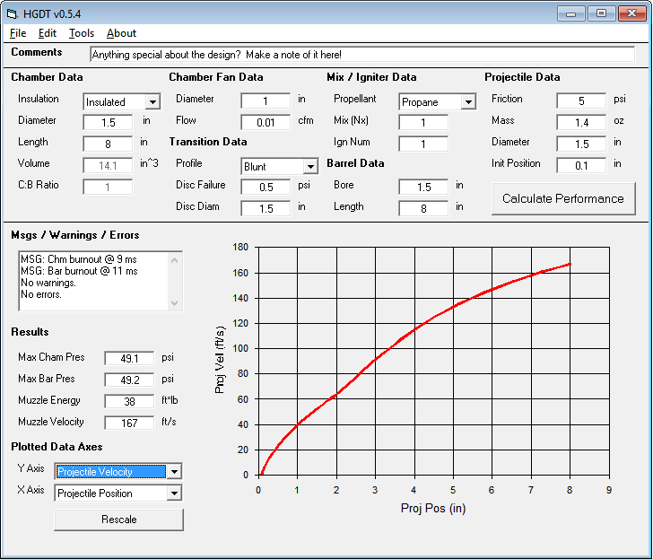

Sun Jun 26, 2016 3:17 pm
Here is a quick calc using HGDT. I assumed an 8" barrel and 8" chamber both at 1.5" diameter and a 1.4 oz round (about 40grams). The estimated muzzle velocity is 167 feet per second (~110 MPH). Not all that great but more than twice as fast as you could throw a spud.
