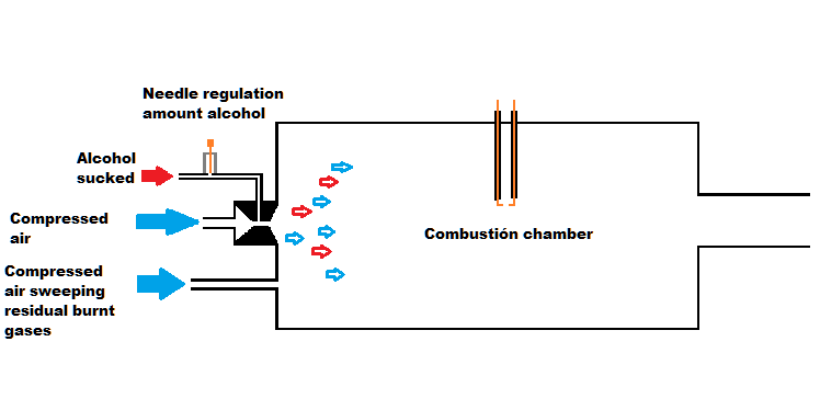

It can be a simple option, introduce the pulverized fuel and mix it with the air in your explosion chamber. The compressed air should be regulated in quantity and time, so that it does not vary much between each shot. The amount of fuel, alcohol, that enters its combustion chamber along with the compressed air, is what can vary with the regulating ajuga, exactly equal to the carburation system that the small glow engines have, of aeromodelling.
Ethyl alcohol, in cold days, less than 15 Cº, will not evaporate. To start you must warm a little, up to about 30Cº your camera. The fact that the alcohol is pulverized, facilitates this, without doubts. I recommend DO NOT use methyl alcohol, because it is very toxic. Their vapors are dangerous, no doubt.
It is necessary to eliminate the residual burnt gases from your combustion chamber, before discharging. A little air alone, and then the mixture load. Its stoichiometry can be excellent, if it keeps the amount of air for each shot always the same, and the same, with the amount of alcohol.

In my combustion weapons, in winter, I heat them a bit, (the aluminum walls of my combustion chamber), with a hair dryer. I live near the tropics, and I have a warm climate almost all year round, but on cold days, I proceed like this. Once hot, the explosion chamber is maintained by the action of the shots.
The "serious" option is to wind copper wire to the explosion chamber, on the outside, as an electrical resistance, and to pass a little electric current from a battery on board the weapon, coupled to a simple thermostat. It would be necessary to design this topic well, to maintain an ideal temperature. I calculate according to my experience, that with 40 Cº enough.
On the other hand, speaking of your first idea, if you increase the amount of liquid alcohol and lower the air pressure, it is equally dangerous. You never know if the alcohol is running out, or how much it evaporates according to the ambient temperature ... a PUM can happen !!! :roll: just when you're playing with your burning weapon, and in the best part of the game, it's the law of murphy :shock: If you want a stoichiometric mixture does not work out well, if you do not want it because of the danger of explosion, it will form perfectly ...
Keep in mind that the amount of alcohol vapor may be independent of the amount of liquid alcohol you have accumulated. I do not like to run that risk, having other, safer options.
