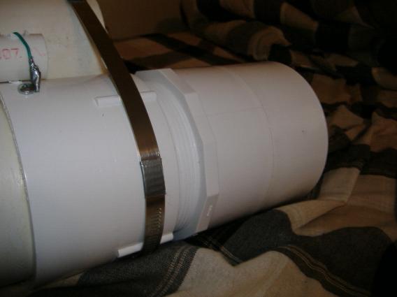

It's obviously better to use pressure rated fittings, but in the past me and many others have used DWV fittings for simple combustions. That said, I'd recommend looking on mcmaster and getting what you need. To replace the cleanout adapter and plug just get a threaded adapter and a SCH-80 threaded plug. You can also use camlocks and plugs instead.
For one of my old cannons I used a cap, male adapter, and female adapter since it's all I could find locally.
