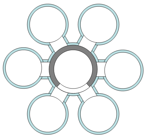

jackssmirkingrevenge wrote:
iknowmy3tables wrote:I love it, the design is brilliant
ditto, very ambitious but it just might work :)
are you still not clear on how the fuel injection/venting works? look at the diagram below imagine the blue part rotating around the gray part and a continuous flow of air mixed with fuel blowing in from the gray tube into the blue chambers
as far as I've seen this is the only automatic combustion design that doesn't use timing circuits, and I'm a fan of passive engineering designs
this is just my interpretation of the design
fuel air injection on gatling.PNG (28.1 KiB) Viewed 8877 times
spudamine
Posts: 184
Joined: Sun Nov 23, 2008 2:47 pm
Mon May 03, 2010 1:50 pm
I think jack probably grasps the concept :lol: I'd agree the idea is very clever and the implementation so far is looking good. However the complexity of this is probably sufficient to throw up quite a few problems. What is worrying me is getting enough fuel/air into the chamber for a decent shot in the short time the chamber is open to the central manifold. Bear in mind the mixture is only being pushed by a fan with several corners to negotiate. Hopefully it's a powerful little fan :)
