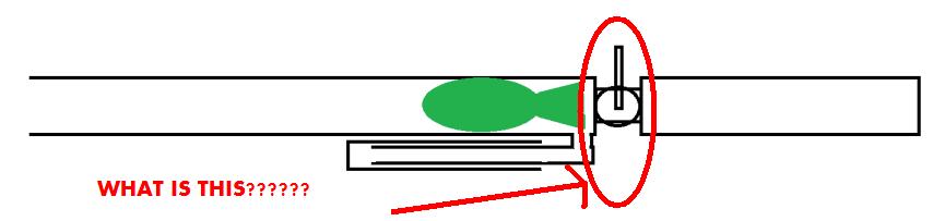

I have an air ram on it to simulate the recoil of a field gun. Its hard to describe. Look at this : http://www.spudfiles.com/forums/ways-to ... rt,15.html
It pushes the whole barrel and chamber backwards upon firing on a set of tracks with elastic bands to return it to original pre-fired position.
I am not sure, but my cannon is the first one I have seen with an airram on it, but it works great.........if I can get a good combustion.
Tue Jul 17, 2012 2:56 pm
Recoiled_monsteR wrote:I have an air ram on it to simulate the recoil of a field gun. Its hard to describe. Look at this : http://www.spudfiles.com/forums/ways-to ... rt,15.html
So you use the combustion gases to help recoil the system? Perhaps you should upload some pictures or a diagram.

Recoiled_monsteR
Posts: 16
Joined: Fri Jul 06, 2012 10:28 am
Tue Jul 17, 2012 5:44 pm
This is exactly what I did in a nut shell

Tue Jul 17, 2012 6:18 pm
Looks to me like that setup would (1) make the recoil worse, (2) waste energy in making the gun recoil and (3) not return the gun to the starting position after firing.
Tue Jul 17, 2012 11:49 pm
jimmy101 wrote:Looks to me like that setup would (1) make the recoil worse, (2) waste energy in making the gun recoil and (3) not return the gun to the starting position after firing.
I think he wants to boost recoil for an artillery effect.
Still, I'm confused, that looks like a ball valve pneumatic but we're talking about a combustion :?
Crna Legija
Posts: 2333
Location: australia
Wed Jul 18, 2012 3:05 am
What is the thing in the middle between the chamber and barrel?
