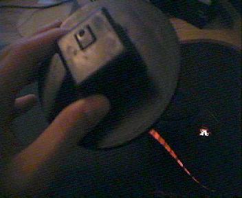

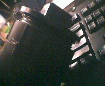

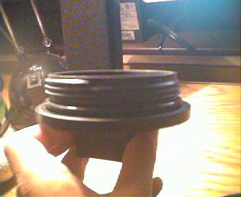

check out my cap

yo
yo
Picture 002.jpg (15.17 KiB) Viewed 3585 times
yo
yo
Picture 001.jpg (15.26 KiB) Viewed 3585 times
Deadeye
Posts: 22
Joined: Thu Jul 17, 2008 4:27 pm
Location: St Louis MO
Wed Jul 23, 2008 10:28 pm
I don't need the backside that has been established, but shoot one of the cap threads and the female threads on the cleanout so I can maybe see what all you will be buying tomorrow.

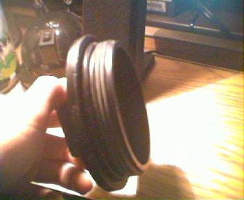

Wed Jul 23, 2008 10:36 pm
check it out yo oh and i checked it out, the cap has 3 threads, and 1 of them doesn't go in
Picture 004.jpg (17.74 KiB) Viewed 3576 times
starman
Sergeant Major
Sergeant Major
Posts: 3027
Location: Simpsonville, SC
Wed Jul 23, 2008 10:47 pm
Yo?... :roll:
You're not getting enough threads screwed in there... pretty obvious I guess. You need to get at least 3 or 4 screwed in. You may need to file some flashing from between the threads....and also, wind a couple of layers of teflon tape on them.
Most of us have had a clean out cap blow out the back, a pretty common happening with spray n prays.
The axe should be fine. Looks like you didn't use enough however and you are waiting too long before screwing on the cap.
