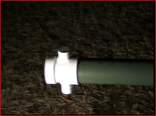

McCoytheGreater wrote:We're thinking of something similar to Jeepkahn's design. He says it removes a considerable amount of recoil. We're thinking 4" pipe at 8" long ported on the top and sides to reduce muzzle flip and recoil and in actuality giving us a version of a compensator type muzzle break. Here's the question. Jeepkjan's brake is open on the end, while i've seen others where the brake is reduced back to just over the bore size. I'm pretty sure the reduced ended muzzle break will work slightly better than the open ended one, but I don't want to risk our sabots getting lodged inside the brake. Is my paranoia well founded?
Sorry i didn't see this sooner, But, my brake is not open on the end, it's bore is only 1/8" larger than the barrel bore, it's made from a piece of 1.125"IDx2od" aluminum pipe/tube...

The Muzzle brake actually vents towards the back. No need for elbows. The fitting does it for us. We are going to slice off the connector parts for the 2" holes. That will help the gasses vent back more. Thanks, anyway Jeepkhan. We were seriously thinking about a ported brake. We looked around our local hardware store and came up with this one.
The pic is not very good. It's a still from a movie.
Muzzle Brake.JPG (38.04 KiB) Viewed 4096 times

Sun Jan 24, 2010 12:20 pm
What a monster! :twisted: I like it. I'm really surprized that the muzzle brake made that much difference. OTOH, I did have a large pneumatic that gave significant recoil w/o a projectile, so I guess it's reasonable.
Sun Jan 24, 2010 12:24 pm
Skywalker wrote:I'm really surprized that the muzzle brake made that much difference.
If they weren't worth the trouble, would they hang this much metal on the business end of the M109 ;)
