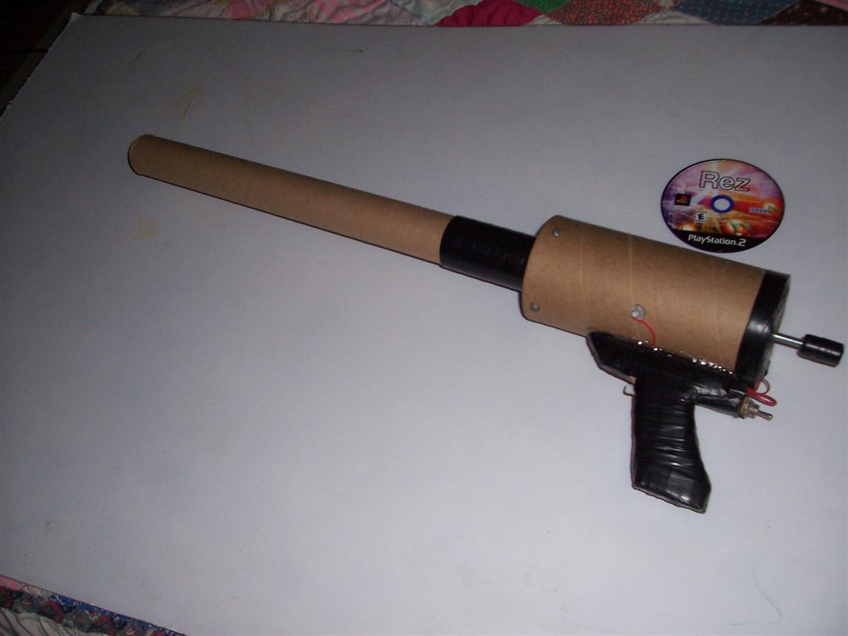

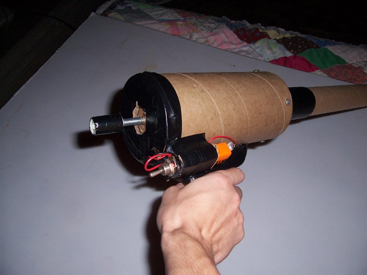

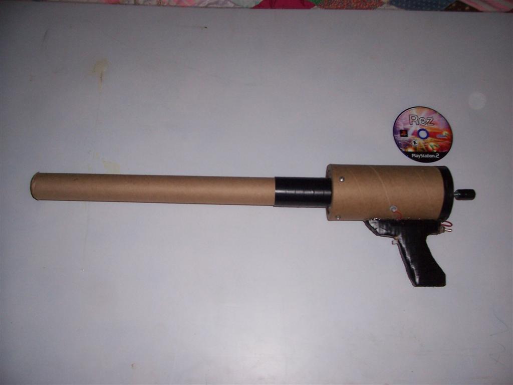

Yeah, it's a cannon made out of cardboard tubes.
This was the result of extreme boredom over the last two days, and the fact that golfballs fit perfectly in paper towel tubes.
Stats:
-48 cubic inch chamber
-42 cubic inch barrel (21" long)
-1.1:1 CB
-Chamber Fan
-Single spark gap
-"Drain Plug" style venting (similar to gort's Blue flame II)
-Bio-degradable
Total spent:
$2.50 on igniter
The chamber is made from 3.75 inch sch 160 cardboard. The barrel was made from DWV paper towel tubes, so I layered it with duct tape and sleeved it in a thicker tube
This gun (which I'm calling the "Hobo Blaster":)) was just one of those "I wonder if I can..." things. The only parts that aren't made of cardboard and tape are:
The fan circuit
The igniter
11 screws
Glue
Range is around 100 yards with a golfball, but hey, it's a gun made from garbage.
Semi-rare PS2 cd for size comparison :)
