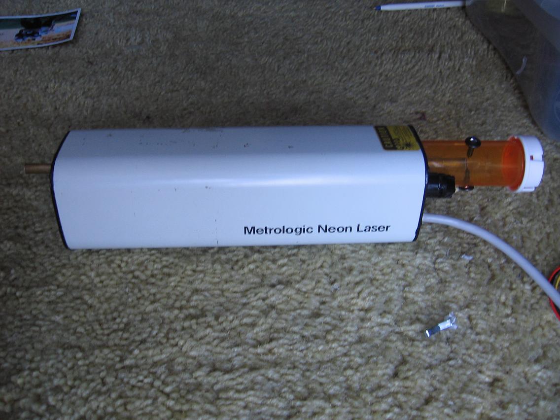

I used an old cerca 1970 laser. Removed the laser tube, stuck in a barrel and chamber and had fun! In a certian conext I made a laser cannon! Video will follow shortly.
The only current picture I have

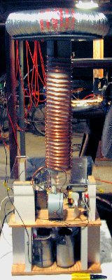

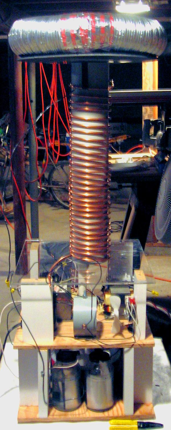

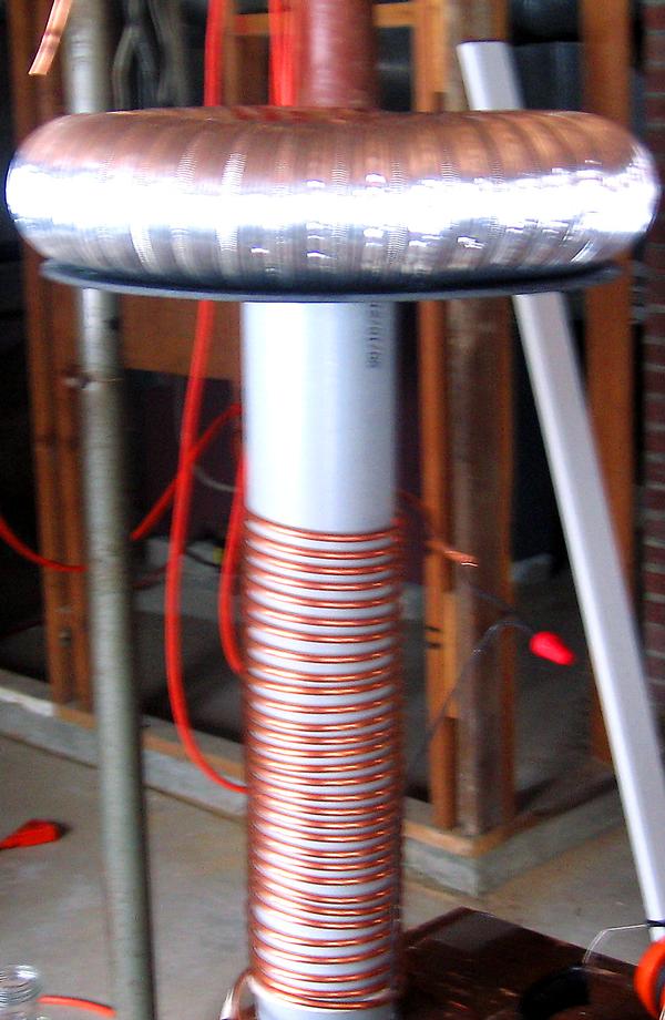

Carlman wrote:it may be a bit offtopic but could you show this 1000w laser lol
lol it's off topic, but I'll show it anyway (It's my pride and joy :D )
But lets not get carried away on this and keep on topic
A 300000 volt power supply, homemade too.
This is a better picture of it.

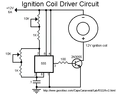

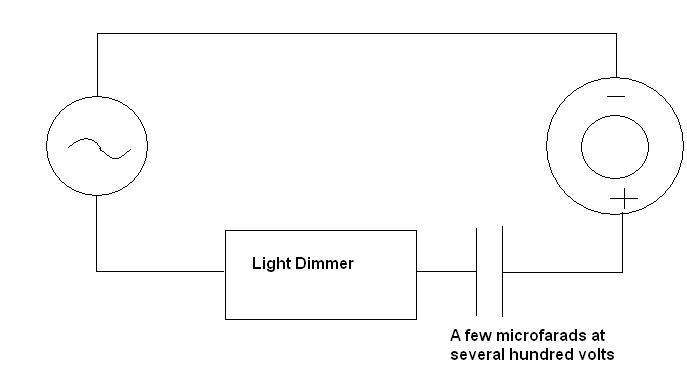

There are two different ways to get an ignition coil to work. One way is through a 12v DC circuit and another is a 120v AC circuit. You're choice.
This circuit is the more complicated one. You may have to order the parts for this. However all the parts are relatively cheap.
This is a basic ignition coil driver circuit for an AC wall power supply. The circuit uses a capacitor partnered with a wall dimmer switch. The best place to find the capacitor recommended for free is in an old TV or microwave and the best place to find the switch is Home Depot.
