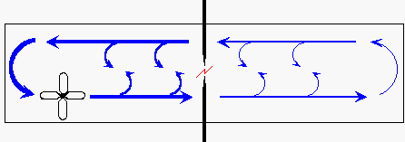

Okay, new idea:
Rotational flow.
Quick sketch/diagram:
Just an idea.
Discuss :D
