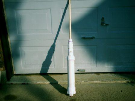

TYpical combustion cannon but has a carrot barrell
jjk92
Posts: 127
Joined: Thu Apr 06, 2006 5:22 am
Thu Apr 20, 2006 7:39 pm
this combustion cannon is completly normal except that that barrell is the right size for shooting carrots and chunks of potatoe proplent: propane butane anti static sprayhair spray binaca on occasion
Benny
Posts: 844
Thu Apr 20, 2006 7:42 pm
what sise barrel fits carrots?
jjk92
Posts: 127
Thu Apr 20, 2006 7:46 pm
1/8-1/4-1/8 in the yellow pvc stuff
spudshot
Posts: 1036
Thu Apr 20, 2006 8:45 pm
