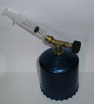

No more dangerous than igniting deodorant. Here's another way of getting the same/similar gas:(I think I'll use deodorant, lighter gas is too dangerous)
- meter.JPG (34.37 KiB) Viewed 3591 times

My point was, it's useless being worried about butane and propane then not worrying about deodorant, one isn't really more dangerous than the other.
