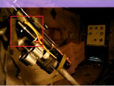

- What is this?
- redbox.jpg (22.1 KiB) Viewed 13315 times
@pimpmann22: in the red box: this black box contains the electronic ignitor and battery, you can see the red wires on right, going into chamber.
