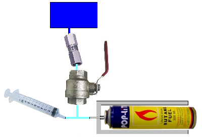

As to fuelling, here's a self-explanatory thought:

Xalexalex wrote:I like the idea, but I was looking for something... quicker to use. I'll check the home depot in a couple of days, see what I can find.
You can cut out the syringe, ball valve and check valve - but then you have no means of correctly dispensing the right amound of gas, so you've made a spray'n'pray.

Sun Aug 28, 2011 12:06 pm
A simple syringe meter is not hard to make.
A piece of tube will do the job.
Btw, is there an introductions thread here? I couldn't find it anywhere =/
You're in it ;)
Use a 3 way valve and a meter pipe. If combined with a fan vent, 5-10 shots per minute should be do-able.
