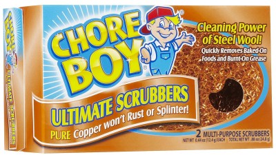

A large volume suppressor packed with heat absorbing material like steel wool (not too fine or it will burn!) can make a significant difference if done well.
Posts: 3643
Been thanked: 62 times
Just don't buy it with little flowers. :lol:
