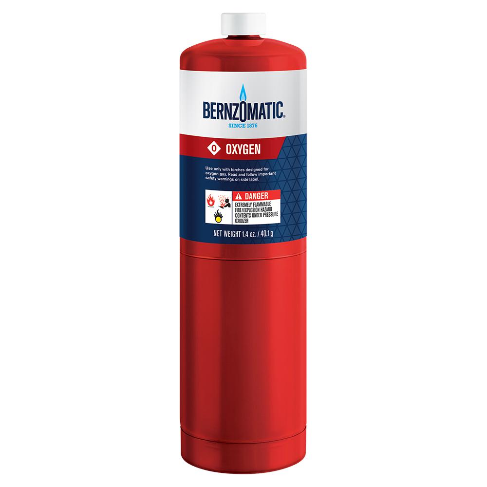

Acetylene is not really the safest fuel for the newbie, despite being expensive, bulky and requiring regulation, it's also somewhat prone to detonation when severely mishandled. Those dangers are overplayed, but still, who wants to cart around a 30lb bottle to let out a few golf balls. If you really want a performance boost, oxygen enrichment from those wee little 40 gram canisters is a much better choice, or a hybrid. Not to mention you're limited to 15psi preignition pressures with acetylene (partial or relative, I don't know).

I think the oxygen canisters that Zeus refers to are these:
https://www.homedepot.com/p/Bernzomatic ... /202044702
- bernzomatic-welding-accessories-304179-64_1000.jpg (36.64 KiB) Viewed 4593 times
