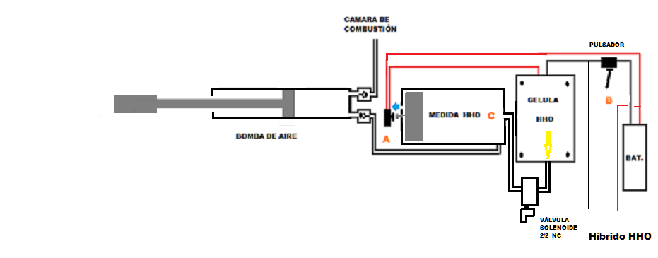

I have thought about this. It's for a weapon that uses HHO pressure, a hybrid that is what I like.Cthulhu wrote:Very true! Although HHO is still safer than storing an Oxy-Propane mix in volume, you can increase the safety by having a switch on the power source to only produce the mix when fueling (the breakdown of water occurs as soon as electricity flows through the circuit).hectmarr wrote:The idea of having the fuel and the oxidant together, in quantity, mixed, and in the gaseous phase, is very dangerous, for example in the particular case of propane and air.
When you activate switch "B", HHO is generated until cylinder "C" is filled. This amount of HHO is what is used for a shot, no more. When the cylinder is full, the piston interrupts the current with switch "A", remaining full. Then, when pumping with the air pump, it sucks the HHO from cylinder "C" and presses it into the combustion chamber of the hybrid. Only generates the amount of HHO just for the shot.
- Híbrido HHO
- Arma híbrida HHO.png (30.18 KiB) Viewed 18543 times

Give him a break Jimmy, the guy is probably the only one around here who built a self contained hybrid repeater. He is more than worthy of being taken seriously.jimmy101 wrote:If you want to be taken seriously quit using the stupid name "HHO". There is no such thing. You are using 2H2 + O2.

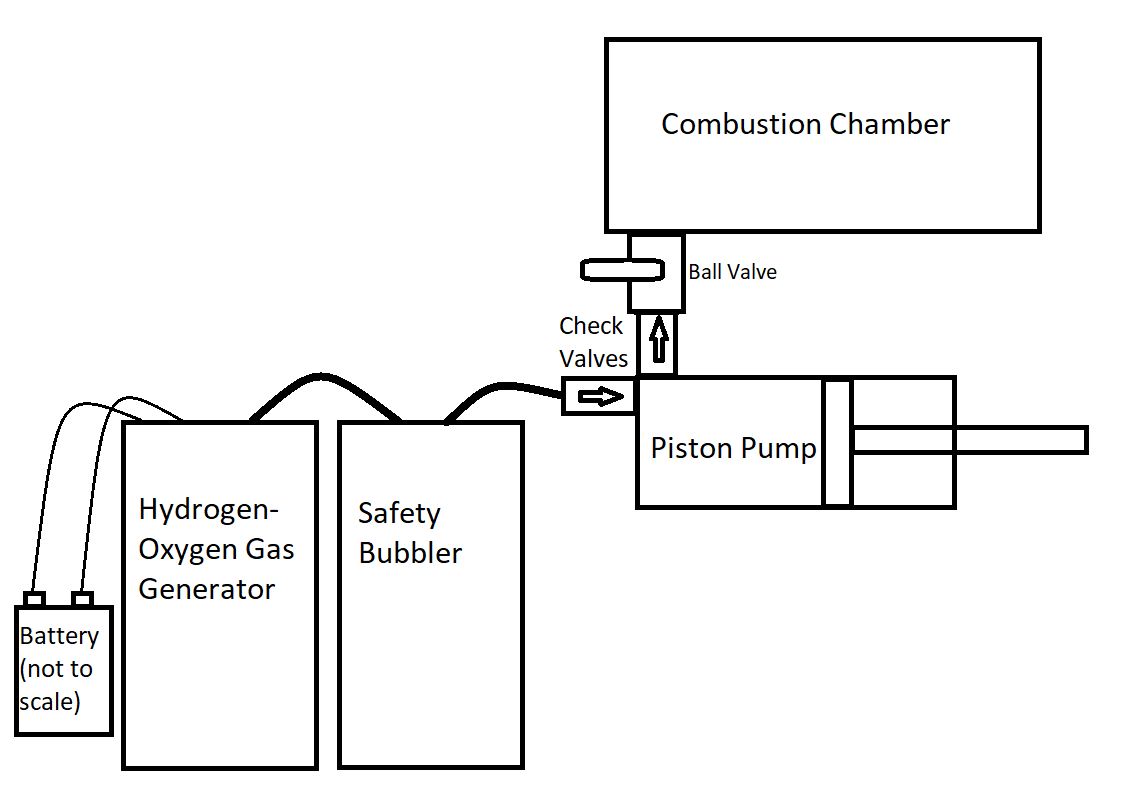

I completely agree, which is why my original post puts "HHO" in quotation marks. I believe a better term would be "stoichiometric Oxy-Hydrogen Gas" (SOG), but considering most of the internet calls it "HHO" I thought it would be better to refer to it as that on the forum.jimmy101 wrote:If you want to be taken seriously quit using the stupid name "HHO". There is no such thing. You are using 2H2 + O2.
I agree! I've been fiddling around with ideas to make the collection and pressurization of the mix easier, but I can't seem to figure out a method that is easily streamlined. If a good method can be made, hydrogen hybrids would be very nice for quick loading and firing.hectmarr wrote:Temptation to put about 50 psi the HHO inside a container of this type that shows the video, with the ammunition stuck, and then the container inside a tube. 10 bottles, "conditioned"and BUMMM BUMM BUMM :bounce:
- Very Rough Idea
- HHO Spudgun Concept.png (30.99 KiB) Viewed 18517 times

The problem I see in your diagram is that the air pump sucks directly from the HHO generator. It would be very complicated to calibrate the production of hho so that it does not produce vacuum when vacuuming the pressure pump. If the pump sucks more than the generator can give, it probably would fill up with water.
The cylinder "C" that I drew in my diagram, eliminates this problem, because you have all the necessary amount of programmed hho that is needed, before aspirating and compressing with the "air" pump. We should say HHO bomb. The production is interrupted automatically when cylinder "C" is full.

Thats a really good point, maybe if the piston begins in the closed position and the pressure from the generated gas pushes it until it is filled, then the user pushes the piston in to pump the gas and once again allows the pressure generated by the cell to refill the piston body it would work. Either way, its definitely finicky and you design is far superior in functionality.hectmarr wrote:The problem I see in your diagram is that the air pump sucks directly from the HHO generator. It would be very complicated to calibrate the production of hho so that it does not produce vacuum when vacuuming the pressure pump.

My opinion is that it is first necessary to produce the amount of hho that you want to burn, and that this production process stops automatically, and then compress it in the explosion chamber. The solenoid valve that activates together with the manual pushbutton "B" passes hho and moves the cylinder piston "C", from right to left, until this piston cuts the current when pressing and disconnecting contact "A", stopping the production of the generator, avoiding having the hho under pressure. When this happens, the solenoid valve is deactivated and closed, preventing the hho compression pump from sucking and generating vacuum in the generator. The hole with the small blue arrow lets out the air and avoids storing the hho. When you pump, the suction causes the piston to move to the right, until the entire hho is suctioned.
Surely there are several ways to do this, a matter of spinning the issue.
