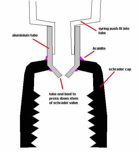

Oh and by the way JSR, how were you planning on filling your hybrid project with a syringe? did you have a special valve or just open and squirt it in... ?:D

FordGtMan wrote:Oh and by the way JSR, how were you planning on filling your hybrid project with a syringe? did you have a special valve or just open and squirt it in... ?:D
Basically I modfied a schrader cap in such a way that it kept the valve open when it was screwed down, and the syringe nozzle could push-fit into it.
