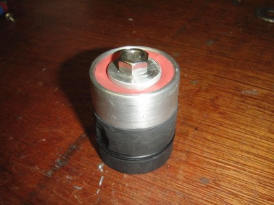

A few days ago I was testing out a project and made an interesting observation.
I had a piston made from a solid chunk of neoprene which developed sealing issues, after taking it out of the valve it looked as though it was vaporizing a little at a time around the port. This is the first time I've ever seen this happen, though there is a different chamber and valve profile in this gun than my past launchers had.
When was the last time you hybrid guys looked at your sealing faces? any similar issues?
This happened over maybe 20 shots.
Sealing face burn-out

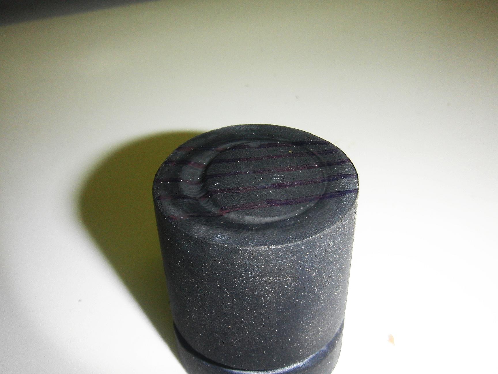

I guess I've had similar results:
I had to change the sealing face several times because of this, I gradually started using thicker and harder rubber. The sealing face below was the last one used on that piston and was still working before I changed to the aluminium piston. The rubber I used for it came from a boat trailer roller, which is some really hard rubber.
You can even see how the heat has smoothed off the rubber along the body of the sealing face; notably the edge between the front of the sealing face and the body.

I've made a different piston which should hopefully be immune to most of the carbonizing problems, though not sure when I'll be able to properly test it. I don't have much shooting space for this gun.
