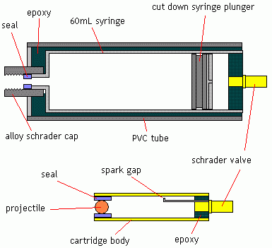

I fear something like that would be liable to blow up, it seems to make more sense to me to have something like the alternative filler presented in this diagram, where a pneumatic piston compresses a 1x mix while filling the cartridge - slowly of course, we don't want a single use diesel engine :roll:

I think it might be a good idea to build a sort of stirrup meter... basically something that will let you first achieve the right mix and then compress it easily (and safely) to 10-15X....
it would be cool if you could find a way to use standard filling adapters for shrader valves
Wed Aug 04, 2010 12:43 am
POLAND_SPUD wrote:I think it might be a good idea to build a sort of stirrup meter... basically something that will let you first achieve the right mix and then compress it easily (and safely) to 10-15X....
That's pretty much what I was sketching while you posted that :D
This is what I was thinking of, a slightly more sophisticated approach that uses schrader valves for filling and a reinforced syringe to compress and inject the mix, allowing high mixes to be reached easily. I drew it with pneumatic compression but a manual stirrup handle as you suggested will work just as well.

Would I be correct in thinking that you're unlikely to have issues with air leaking from behind the plunger to the front, and ruining the mix, as there will be (almost) equal pressure on each side at any one time?
I get the feeling that using air will be more effective than compressing it mechanically with a stirrup for that reason...
Wed Aug 04, 2010 1:15 am
with a good seal that shouldn't be a problem...
Wed Aug 04, 2010 1:24 am
POLAND_SPUD wrote:with a good seal that shouldn't be a problem...
Agreed, however for the sake of practicality I'm more inclined to the stirrup system. We'll see, I'll be off on vacation soon so it might be a while before you see the complete system come to fruition.

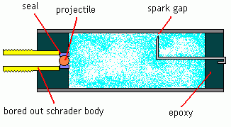

Nothing actual, and I'll be away from my workshop for a week as of tomorrow. In the meantime however I've been reshuffling configurations in my head, I like the simplicity of using the projectile as the valve but at the same time the screw attachment system of the schrader to the syringe makes sense, so I was pondering making a... well, hybrid :) something like this:

I had flirted with the idea of union based burst disks but as Spudfarm said, that beats the point of making a simple and easy system, for example the last design I posted wouldn't work as you'd need a separate filling valve.
