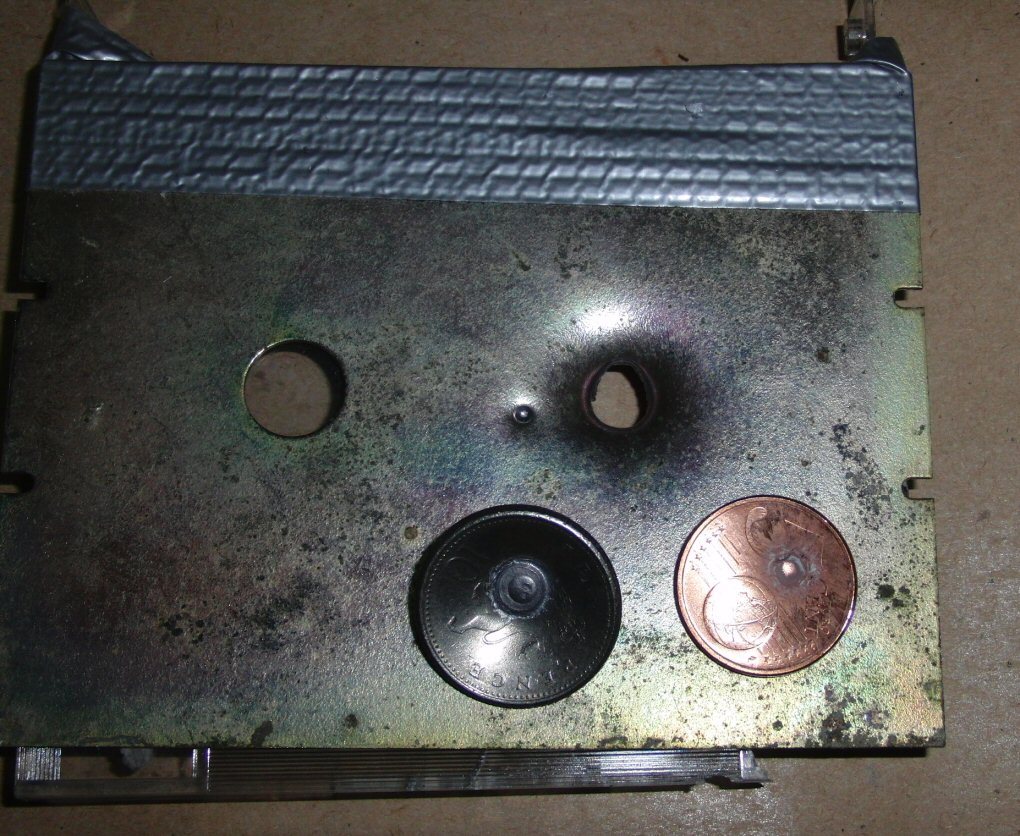

Hate to butt in the discussion, but extra barrel length or not, this thing is LOUD! (subjectively)
It's too dark for chrony data, but did some damage shots and the performance increase is very evident.
Here it is firing a flared out 0.22" pellet fired at 1mm thick steel plate, punched right through and as it disintegrated against the hard surface behind it, made a mess of the "witness" paper:
Long suffering UPS case, as you can tell from the paper background this time the pellet made it clean through both sides :D
0.25g airsoft BB fired at a 5 euro cent coin, no penetration but it printed the coin on the metal cap support and left a pretty deep dent
0.22" pellet vs a 10p coin, again no penetration but the pellet fused with the coin and dented it quite deeply, to the extent that if you look at it from the other side, the queen looks like she's got a mouth full of sweets :D
Here's the targets:

Not as impressive as I hoped, however when fired at the UPS case, a 0.25g BB made a dent deeper than its 6mm diameter which was quite significant.

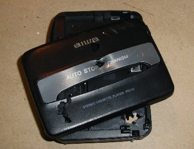

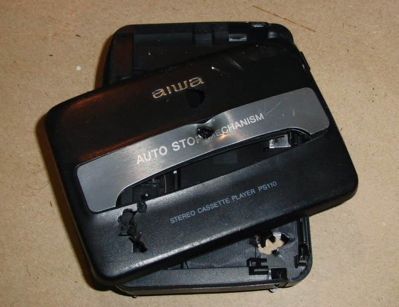

I was sifting through the debris littering the testing area, and noticed something about the walkman - it seems that the "auto stop mechanism" doesn't stop near supersonic lead pellets, someone should tell Aiwa :D
