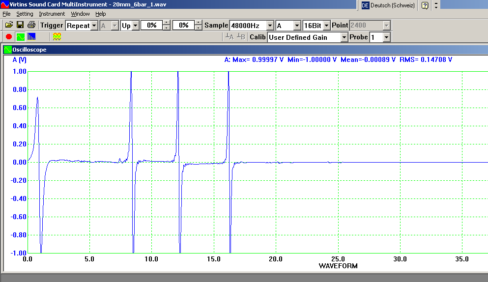

I wanted to make a complete and documented presentation before saying anything, but anyway:
Get some thin copper wire.
Get a length of pipe, 1 ft or so, large enough to shoot through (maybe 2 x your barrel diam).
Wind 100 turns at each end of the pipe. Wind nice and tight (not distributed across more than a few mm).
Wind a 200 turn coil on a length of pipe. This will be the trigger coil; it goes on the barrel of the gun.
Put a 1 kOhm resistor in series with each coil. Put all the coil-resistor combinations in parallel. Connect to the mike input of a pc sound card.
Get an old hard disk drive, blast it with the gun, and get a fragment of the magnets from the arm assy. About 2 x 2 x 2 mm. Build fragment into projectile, so that one smooth side faces forwards and one backwards.
Get a sound card oscilloscope program for your computer. Place 2 pipes in front Hook up everything.
The only hurdle is in getting the oscilloscope to trigger, so the data recording will start at the right time. That´s what the trigger coil is for.
Make a few test runs where you just drop the projectile through a pipe that goes through all the coils. When measuring for real, turn down sensitivity to 1/10 or so - voltages will get a lot higher.
I assume it´s obvious to everybody how to read the graph on the oscilloscope
Regards
Soren

Hi, Jimmy,
Yes, the nicest solution is probably a phototransistor based one. But either you will need a fancy modulated light source, or an AGC input circuit, or both. Or you will have to make major readjustments every time a cloud or a tree gets in front of the sun. I have lost patience with simple phototransistor circuits.
The coil set-up is simple; it is just .. copper! Well, lacquered copper. I got this kind of plots on the scope program last time I cronied:
Just a suggestion anyway
Regards
Soren

- Oscillogram from the firing of a 20 mm sprinkler valve gun. When knowing the spacing of the coils, velocities and accelerations can be calculated. This particular shot was 150 m/s average between the last 2 coils. The low amplitude of the first pulse is because of the low velocity there; that´s why I suggest more windings on an extra, 0´th trigger coil.
- 20mm.PNG (31.96 KiB) Viewed 2801 times

Why in the world would you need a modulated light source for a phototransistor detector? All you need is a constant source that is sufficiently brighter than ambient. Heck, point the PTs down towards the ground and have an IR LED pointing back up at it. At the range of a couple inches in the IR LED will be much brighter than the IR reflection off the ground. Passing clouds etc. won't make any difference.
With my homemade chrony I just use the bright sky as the light source. Passing clouds etc. have no affect on the performance. The only trick is that the PT will saturate in fairly low light, so there is no delta signal between the low light level and the high light level. Easy enough to correct, just put a small aperture in front of the PT(s) so the field of sky they see is small. I've found that a 1/16" or 1/32" aperture will make the PTs work, without any calibration or correction, in lighting conditions ranging from full direct sun all the way down to indirect light in my garage at night (a couple 100W bulbs).
Your magnetic based detector is cool, and clever, but it requires mod'ing the ammo (adding the magnet) and is not easily transferred from gun to gun. In addition, I don't think it will work on a metal barrel.
