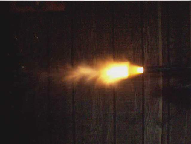

I just did the formula and found the optimal 6x figure is ~112 psi in my 1.8 ci meter, which is only 4 psi higher than what I've been running it at.
When I finish the second version of my hybrid, I found the optimal 1x mixture by finding the upper and lower explosive limits at 1x, making these into percentages and finding 4.2 base on those numbers(it ended up at 18 psi).
Then I just multiplied by the mix number and went from there.
Unless I did something in the equation wrong.
C volume: (somewhere around) 41 ci
M volume: 1.8 ci
Edit: Freeze frame!! :):)
Gah... when I fired it with my mouth open I felt a concussion wave in my lungs.. weird but pretty cool.
look at the base of the flash compared to the end of the barrel. Oh I got a compressor for the hybrid working by the way :)<br /><br />The chamber fan seems to be creating a mildly noticeable increase in noise, at least with the blank shots I've done.

cool i don't get any muzzle flash from my hybrid at 5x (atleast haven't seen one)

Anyway, it's good to see that you got a fan installed in it. That's quite an interesting muzzle flash you've got there. I imagine that it would be (relatively) small and blue if the mix was perfect, and I look forward to trying my prototype hybrid at night to find out. :D
