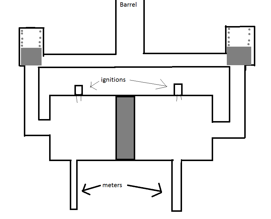

Mon Jul 12, 2010 1:48 pm
what about something like this? when the part of the chamber on the left side of the piston ignites it pushes the piston to the right venting that side and vice versa.

I don't see that as being very practical, if I am seeing this correctly, when the left chamber combusts it throws the piston al the way to the right side, so you would want to put a stop so that the piston doesn't pass your right side meter entrance. Also I would think that you would lose significant pressure due to the piston venting one chamber will cause the volume to of the chamber to double and the pressure to drop in half. Also I think you would have to install a check valve between the barrel and the right and left piston valves or you will have pressurized gasses from one side of the chamber trying to enter the other side when the chamber piston tries to exuast.
Thats what I see.
What do you guys think?

Pat, personally I wouldn't use that setup quite simply for the fact it'll compromise an inline design. Could be wrong, but I'd see your design have a wobble strafe with the flow directions opposing each other perpendicular to the barrel. I would say one chamber may not satisfy my RPM desires, but in that case I'll probably use metal components, and multiple rotating chambers and a single barrel (like this) What I am building now will allow me to observe the RPM/functionality, from that a design with say 6 chambers it'll mainly be a multiple of cost not complexity. If it means anything I see where your going with your diagram there, just the particulars don't hash out for my purpose, soup!
