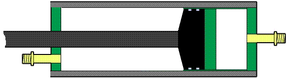

Lockednloaded wrote:That is a much better setup, but I doubt I have that much skillz when it comes to complicated epoxy casting
Why not just make a coaxial? You can make a simple (now that you have epoxy ;)) adapter to fuel through the schrader, no need for a ball valve.

just a quick thought: While using that design, couldn't you also get rid of one schrader and use a piston that is not completely airtight?
Imagine the front schrader gone, you would fill the whole chamber from the back, what would close the piston. Having the ignition in the front/main chamber, the rapid pressure-increase there will force the piston open.
Got it?
Or am I completely wrong with this theory?
Or has this even been build allready?

I need the bv for venting, but the schrader adaptor is a cool idea. The coaxial is a much simpler solution, but I don't know if I can sacrifice interchangeable barrels and breech loading for a simpler sleeker design

nature-boy wrote:Or am I completely wrong with this theory?
The only thing wrong with it is if the space behind the chamber also ignites , you're screwed.
As to whether in practice this would happen I'm not sure if it's been done in practice. It would certainly make things simpler to have just one valve and a non-airtight piston, heck it would make a very sound cartridge design...
Tue Dec 14, 2010 4:25 pm
Lockednloaded wrote:I need the bv for venting
Not really. You're pumping the air in, who cares what's in the chamber ;) a few pumps with the piston in the open position will quickly remove any residual gasses from previous firings.

Why not fill from the back through an air tight piston with a check valve, but you'd have to get valve opening pressure correct if you know what I'm getting at

Compressing the back means you can adjust the popoff pressure for the peak combustion pressure, if you fuel it for a 10X mix and using that pressure behind the popoff means it opens at ~150 PSI.
The peak combustion pressure is beyond 1000PSI in such a mix therefore greater performance can be reached.
Another problem could be met if one used a oxy propane mix, the popoff would be nearly worthless.
/sarcasm, /hyperbole

I don't think that the rear-chamber will ignite with a well made/tight fit piston...or did anyone experienced something compareable?
I think the gap will be to small, and the piston will start moving and vent the chamber before the rear will have time to ignite, but that's just my theory..
would work IMO, but if the rear will not ignite, I dont think its necessary.
But there will be no need for that, by having the same pressure in the rear and in the front, you would always have the right pressure to "pop"?! Wouldn't you?
sorry, I don't understand that... :(
would you bother to explain? :)

If the valve opens close to the same pressure as the hybrid is filled, you will have poor performance because the pressure won't build up as high, if the popoff is the same pressure as the chamber it opens at 150PSI.
If the valve opens close to the peak combustion pressure you have around 1000PSI when the valve opens, a massive performance increase.

Ok. That makes sense to me!
But you can achieve the same effect by altering the OD of the barrel!
With a larger barrel diameter you will have a smaller area the pressure in the front can act on, and with that increase the opening pressure.
corret me if Im wrong.

That's spot on, however it would be quite hard to do, and it needs to be fairly precise.
