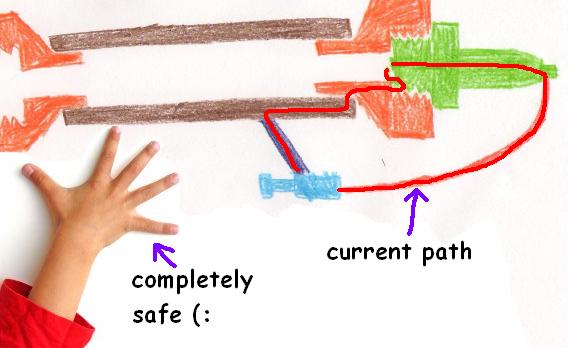

We're discussing hybrids here. The sparker needs to be airtight, and a sparkplug is a pretty logical option.
Not only that, but even if your chamber is uninsulated, and serving as one electrode, you still won't get shocked. You've gotta have two points of contact to get a shot.

ah sorta like power lines right?Insomniac wrote:Not only that, but even if your chamber is uninsulated, and serving as one electrode, you still won't get shocked. You've gotta have two points of contact to get a shot.
if this is the case i think the spark plug is the way to go
put simply:
- painfulbutdeliberateuseofcomicsans.JPG (26.99 KiB) Viewed 3075 times
