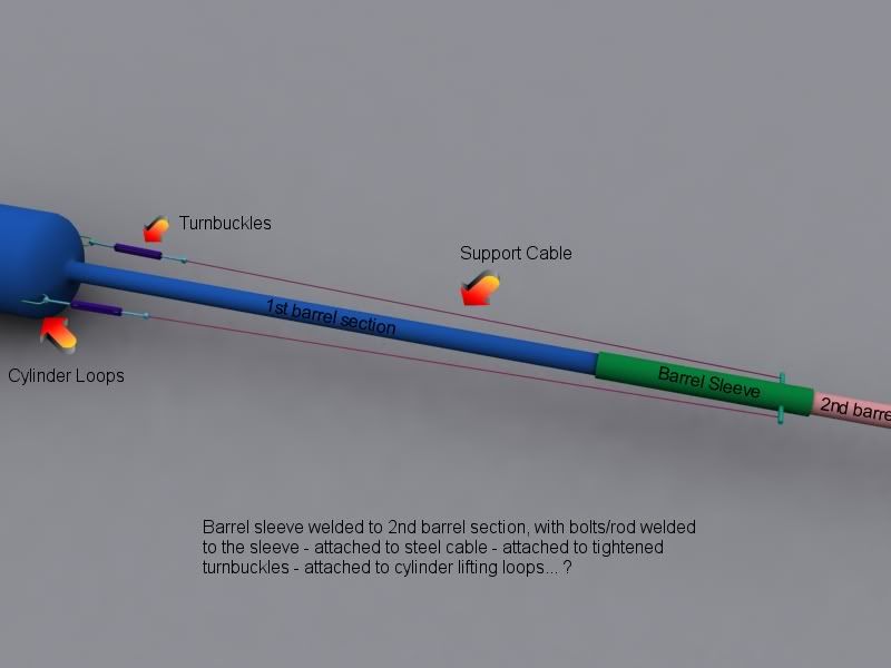

The next hurdle will be the barrel.
I want at least a 2" x 20' barrel that...
1. Won't Sag
2. Won't whip back and forth and snap off the union when fired
3. Can be broken down into 10' sections
4. Doesn't weight a 1000lbs
5. Doesn't cost a $1000
:shock: hmmm

McMaster-Carr item numbers 48855K16 and 6803K17 both fit the bill if you find a good way to connect two of them. You'll require a barrel support no matter what you use.
Sun Oct 30, 2011 12:22 pm
It will all have to recoil as one to keep that noise down, even then it's a tall order...
A lot of bracing???????
Sun Oct 30, 2011 12:24 pm
jrrdw wrote:A lot of bracing???????
Inspiration ;)

Dornep wrote:Thanks for the replies guys.
1. Won't Sag
:shock: hmmm
That thing is a true beast. As far as supporting a 20' barrel, thats going to be a project. Have a look at FEAR (a cannon on this site) I can't find the link to it, but its a huge hybrid kind of like yours with like a mile long barrel. I don't remember even seeing a lot of bracing on his barrel, but go have a look in the showcase or maybe someone will link it. Nice work.

Dornep
Posts: 151
Joined: Thu Aug 09, 2007 5:49 pm
Sun Oct 30, 2011 7:47 pm
Jack.. that picture is exactly the nightmare that comes to mind when I think of raising the barrel into the air on this thing....
I remember seeing the FEAR cannon back in the day before I went AWOL from the site.. To me... his cannon is more of an 88mm flat shooting tank killer while I'm hoping mine will be more like the Paris Gun above... lol
I have an idea of using turnbuckles that i can tighten attached to cables going to the barrel to add support and make a tight barrel seal between the two sections..

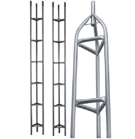

If you can get a hold of a section of this stuff, you'll have most of the work of making a barrel support done for you already. Even steel antenna towers are fairly light for their size.
