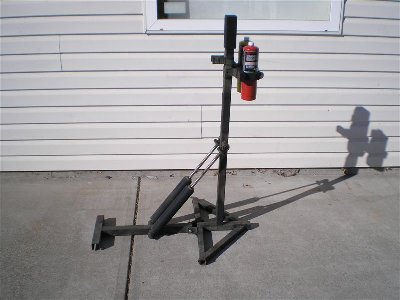

shock absorbing platform with onboard fuel

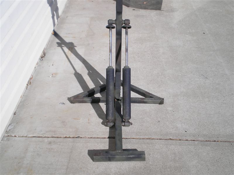

good veiw of shocks
good veiw of shocks

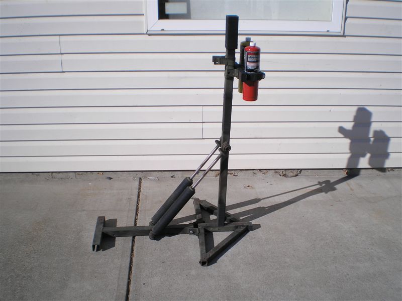

the platform in its extended position

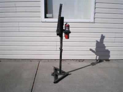

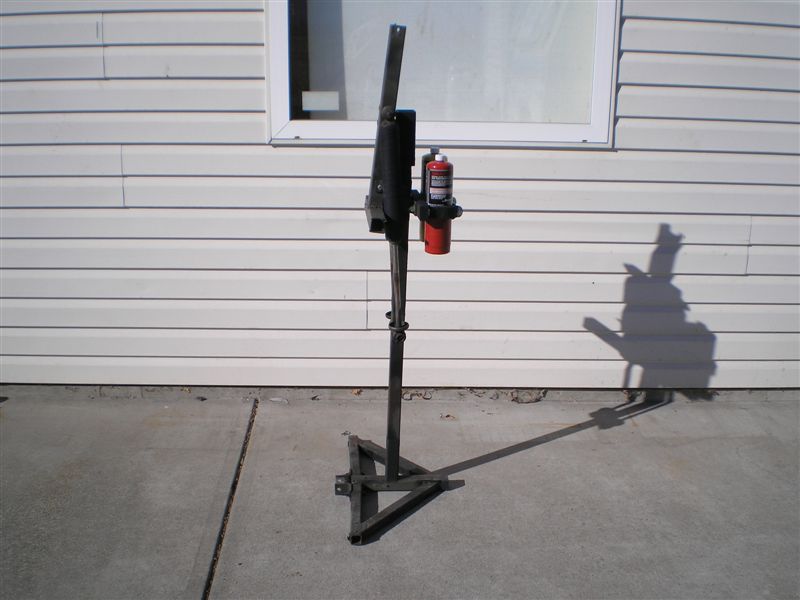

the platform in its folded-up position
