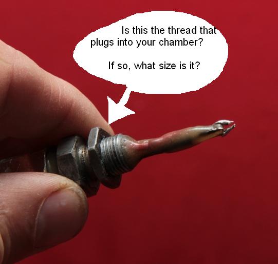

Here is my final electrode that will serve me for tests and later:

Petitlu wrote:Here is my final electrode that will serve me for tests and later
Hmmm... looks a little... flimsy.
Have you thought of using an actual automotive spark plug?
You can get miniature ones for big R/C engines, chainsaws etc, something like this, very cheaply.

yes I have thought a spark plug.
But the diameter is too big and too would weaken the chamber.
Or should be a connector M1/8BSP-F14Metric but I can not find

Question:
Petitlu
Posts: 807
Joined: Fri Jun 03, 2011 4:52 am
Fri Apr 13, 2012 4:46 am
yes, it is 1/8BSP
the spark plug has an M14 thread - 1mm
So I need an adapter 1/8BSP Male / female M14-1mm
Fri Apr 13, 2012 4:49 am
I think it might be 1/8" (guessing from a post made on the first page).
I think spark plugs are perfect for hybrids but there's a reason neither of my two hybrids have them: they're difficult to find in the right thread sizes.
I'm sure I could order one with 1/8" or 1/4" threads off the internet but I've struggled to find affordable NPT/BSP spark plugs online in NZ and I haven't found any in stores. I know they are out there but I got sick of looking.
I could also epoxy them in a galv. fitting but that doesn't really give me much reason to ditch my homemade electrodes.
Fri Apr 13, 2012 4:59 am
Hmmm... I could be inclined to make you a custom one if I have time ;) though really, with a 1/8" nipple, bolt and some epoxy you should be able to make one that can go to 40x and beyond.

Fri Apr 13, 2012 5:14 am
nice, but not one would use when the spark plug?
I'll watch the threads of spark plug radio controlled car
EDIT :
I bought a connector or 1/8-1/4 BSP like this:
http://www.flowfitonline.com/acatalog/O ... D_174.html
With a tap of 14mm-1mm I remake the thread!
