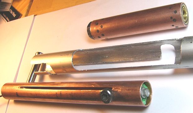

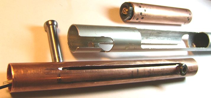

Congratulations on getting it to work, I have a few questions though. Would you mind posting a close up of the bolt itself? I can hear the cartridge snapping into the bolt but an not sure what exactly is happening there.
Also, why did you decide to drill holes at the epoxy fittings? Do they serve any purpose?
Thanks.

The sound isn't actually the cartridge snapping into the bolt, but the breech. I left it slightly smaller than the cartridge so it couldn't just fall out. The bolt is quite basic so far, but here's a pic anyway.
The holes are to increase the strength of the epoxy joint. I hydro tested a similar chamber and it failed at 3300 psi, but held with the holes drilled. Figured I might as well play it safe.

How did you cut out that bolt and receiver Daccel? a dremel?

The cut on the bolt was a chop saw. For the receiver I drilled out the bulk of it and then finished it by eye using a rotozip bit in a drill press. In retrospect, it would have made sense to make the straight cuts on the receiver with the saw. Sometimes I miss the obvious
. But I don't see any reason you couldn't do it with a dremel or drill, it would just take longer. A carbide bit would make life easier.
