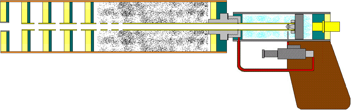

This is what I had in mind, something the size of a pocket pistol which could have a barrel extension/suppressor added on.

combustion. in that design, is your piston supposed to be airtight?

Lockednloaded wrote:combustion.
Ouch. Any idea what went wrong, epoxy not sufficiently cured/thick, surfaces not cleaned/abraded properly?
No, I'm not sure it would work but it will certainly simplify construction. In practical terms it will probably look something like this, still looking at chamber materials.

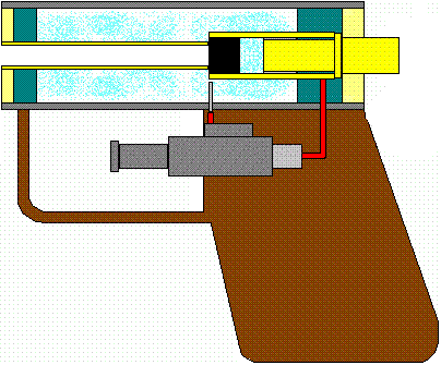

Would an unbalanced piston be a good way to vent the pilot volume once the shot goes off ? Or is that making it too complex ?

he's using a pre-made relief valve. There is no pilot. I'm not sure what you mean by an unbalanced piston. Both of the recent 1.5" porting hybrids vent the pilot with the main piston as it begins to move.
And I retract my previous comment; the back of the relief valve may well be ported to atmosphere. In that case, the valve will close at a whatever pressure above atmospheric.

I think that is what I'm referring to. The piston has a rod through it and a second sealing face larger than the barrel diameter but smaller than the chamber diameter. The second sealing face blocks off the pilot port. Combustion pressure moves the main piston back and the smaller sealing face comes off the pilot seat releasing the pilot volume. A sort of hybrid QEV. ?

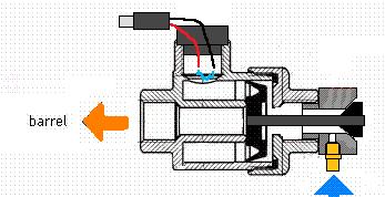

You could add a spring to a QEV pilot:

Mon Dec 20, 2010 2:25 am
ramses wrote:I think he's using the popoff as the main valve.
I had modded a pop-off as a main valve here, the problem is that the piston isn't airtight so it would tend to vent out past the piston as well as the port.

Here is what I meant, I'm pretty sure I've seen this set up before.
Oh and not too sure why I edited the QEV schematic, I should have just used the proposed design.
I guess I would be less silent... But at least it is closer to a burst disk in that once it has opened it doesn't require any energy to stay open.

@al-xg
interesting... but have you noticed that the forces acting on the piston even out?
