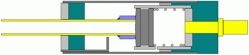

In the meantime I've made a small piston hybrid prototype, to be tested this evening, looks something like this:

Looks good... just to confirm, is the ignition sparking against the barrel? Just want to make sure I'm readin the diagram right
Wed Mar 16, 2011 1:07 am
JDP12 wrote:just to confirm, is the ignition sparking against the barrel?
That's correct. The piston is the seal from a 5mL syringe (just the rubber) and there is a pinhole (literally) in the syringe tube for equalisation. I also epoxied a short length of silicon tube to the breech end of the barrel to prevent it curring into the piston under pressure.
Edit: curring? I meant cutting. Yes.
