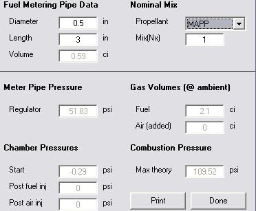

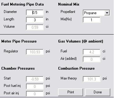

I don't know if this has been brought up already or not, but at 1x it is telling me the pressure rise for propane should be .59psi, and for MAPP, it should be .29psi. Doesn't MAPP have a higher ratio than propane? It also assumes that the fuel displaces air at 1x. that is not necessarily a bad thing, but something worth mentioning. i don't know how the messed up pressures will effect the accuracy of the calculator, but whatever.

ramses wrote:I don't know if this has been brought up already or not, but at 1x it is telling me the pressure rise for propane should be .59psi, and for MAPP, it should be .29psi.
No, it's telling you that you'll have to *REMOVE* 0.59 psi worth of air if you want an unvented 1X mix in that chamber. Similarly, you'll have to *REMOVE* 0.29 psi of air if you want an unvented 1X mix.
Remember, HGDT was designed for hybrids. As such, it's fueling tool assumes a sealed container, yada yada. Is this ideal for simple combustion gun fueling? Nope.
Good news is that there are plenty of fueling tools for simple combustion guns.
It also assumes that the fuel displaces air at 1x.[/quote]
Umm.... Fuel displaces air at every mix except 0x.

What you are saying makes sense now. If the pressure rose, it would be like a 1.02x hybrid or something random like that. :oops:
The main problem that I noticed is that it thinks that the percentage for MAPP combustion is half that of propane. It tells me to fill the meter pipe to ~104psi for propane, and ~52psi for mapp. From the wiki, the ratio for MAPP is 4.6% and the ratio for propane is 4.2%, with pressure rise (4.02$ without). I'm sorry about all the confusion, I just thought it was worth mentioning.
I am also running version 0.5.4. I don't know if that has anything to do with the problem
