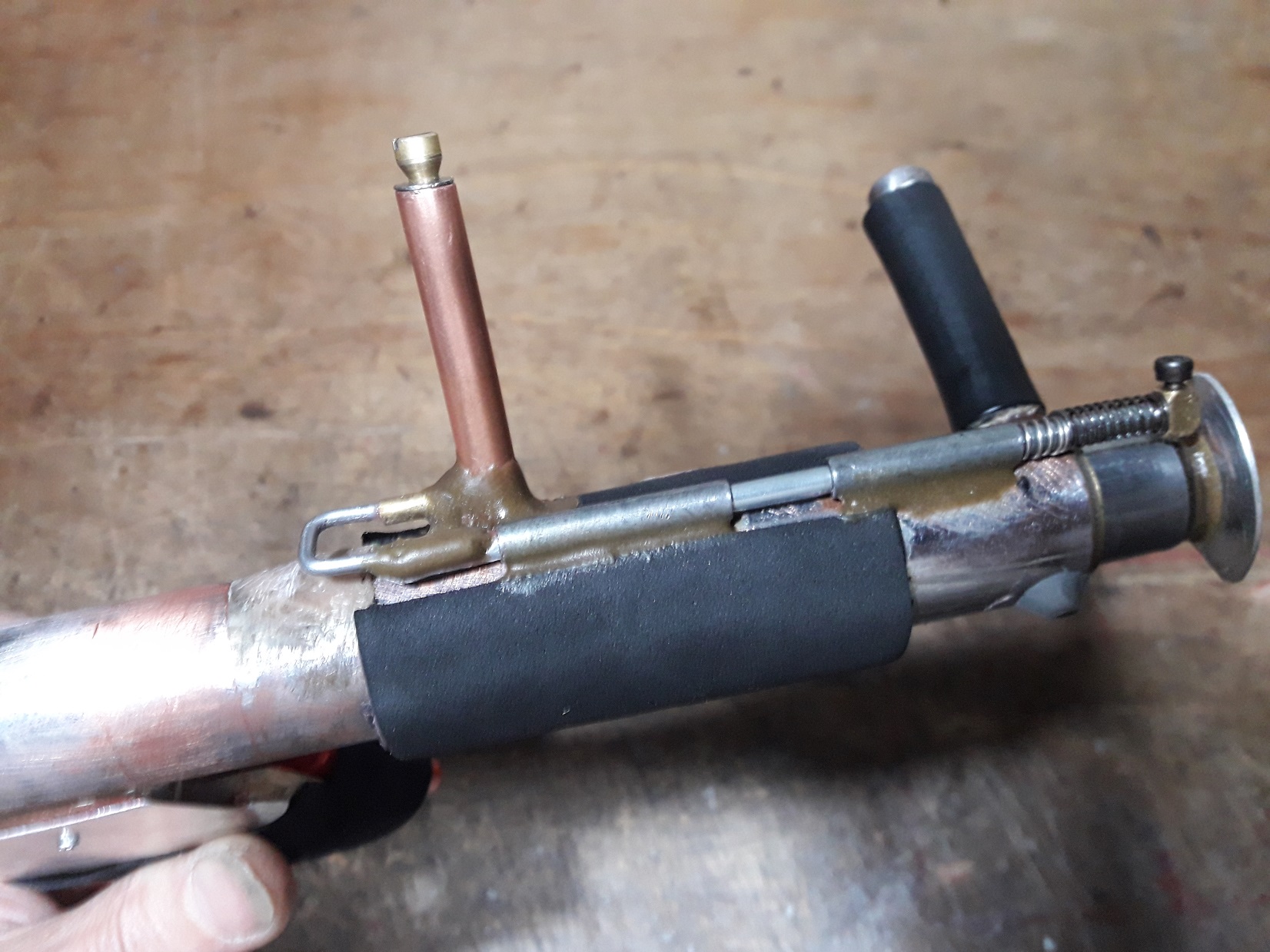

Successful test run! :D The simple charger works perfectly, makes a metallic sound barely perceptible and most importantly, does not fail.
I have charged about 200 bb´s and the small battery seems to still have a lot of charge. The idea is that in the real weapon, the tube that houses the bb's, is below the barrel and parallel to it. For the tests, I have installed a small and very soft spring, so that it works against gravity. When I have time, I will make a video of the test.
This test weapon is the first one I built, and I am using it to test ideas. I leave a picture of the experiment.

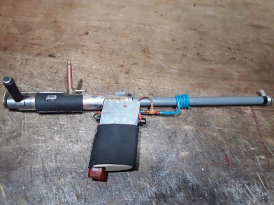

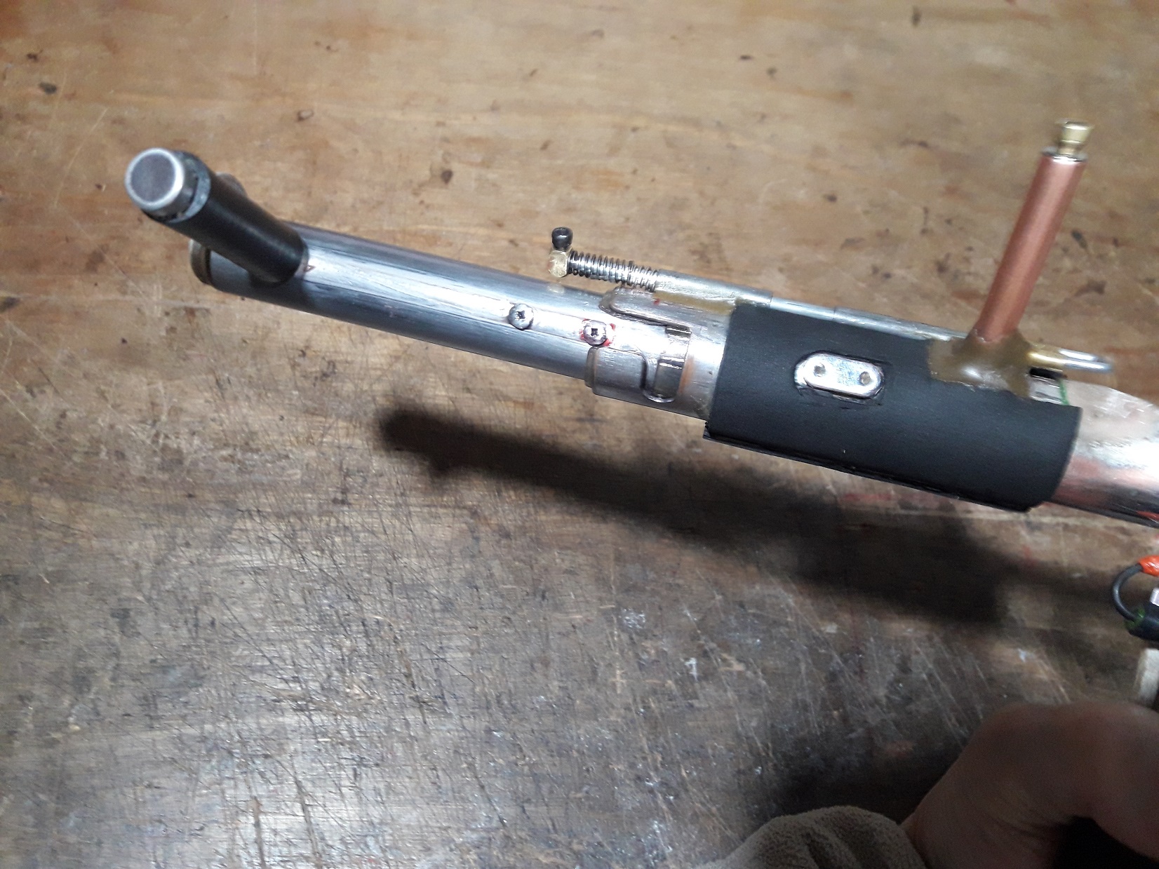

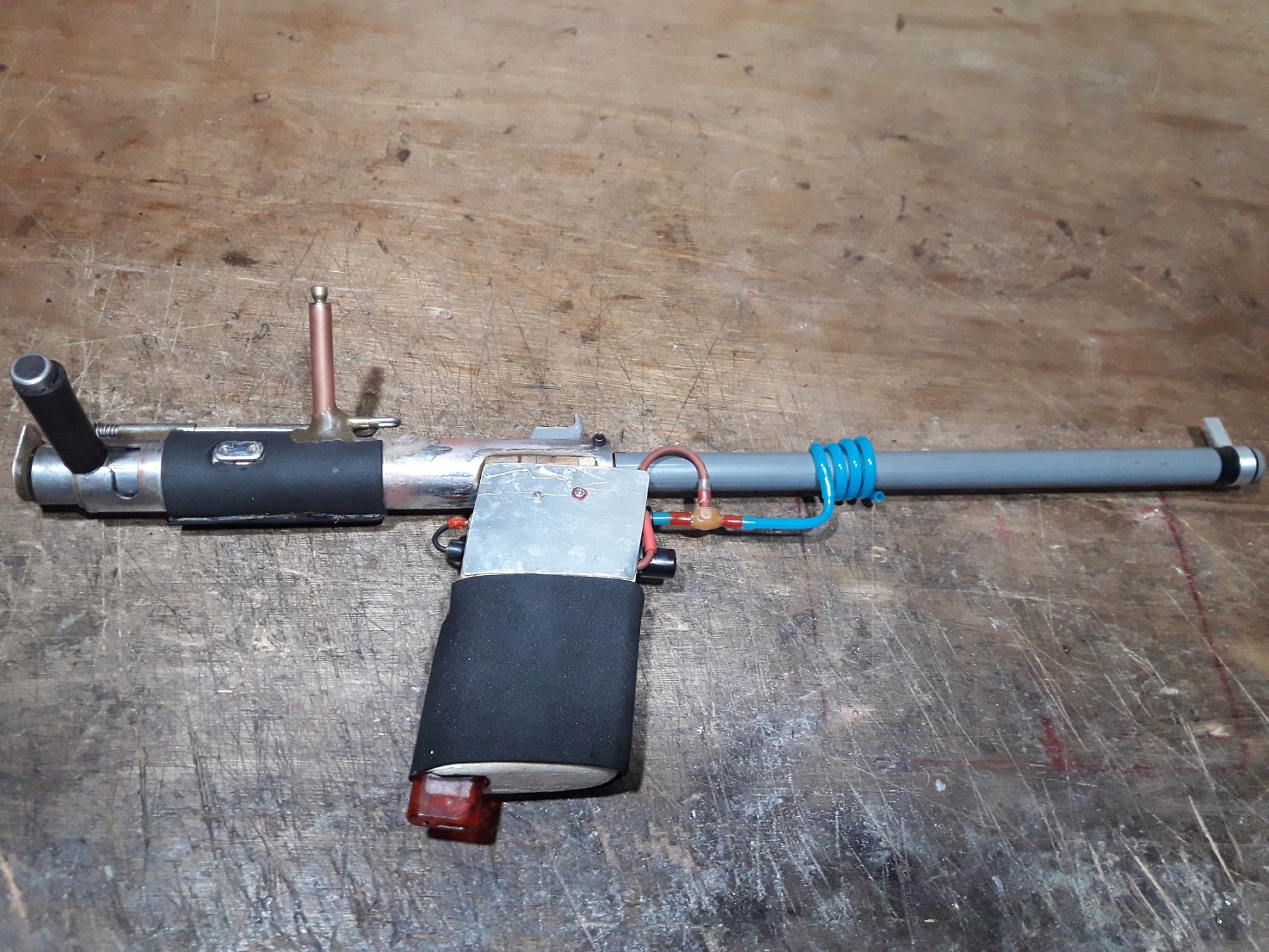

Here some photos of the "monster" that works very well! :D It is unfortunate that it only compresses at 3 bar because the compression cylinder that I used has an internal diameter of 26 mm, which is a lot to generate without any lever, more pressure. What's nice is that you can shoot on repeat and it promises long hours of shooting fun at targets like beer cans, cardboard boxes etc. It is very quiet, because the air is just right, the barrel is a bit long and the pre-compression pressure is low. In the future I will try a long gun with this system, but with a tube no larger than 18 to 20 mm and built more neatly. This was just to see if it works and where the weaknesses are in the overall system to modify the design before spending money on machining parts and materials. :roll:
I will make a video to share here.

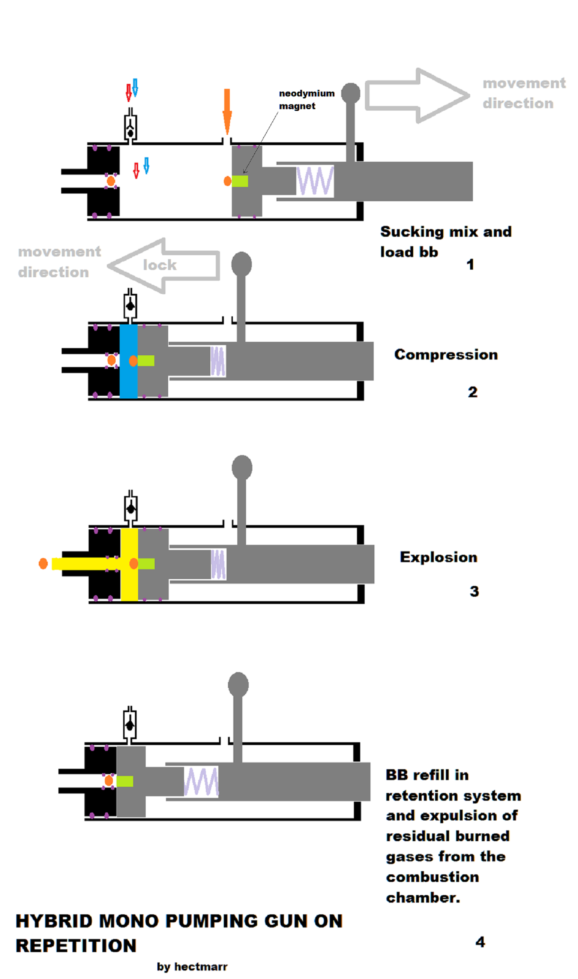

Híbrido MB largo, diseño final..png (7.34 KiB) Viewed 176020 times
Hibrido monobombeo 2, secuencia de operación.png (19.76 KiB) Viewed 176020 times

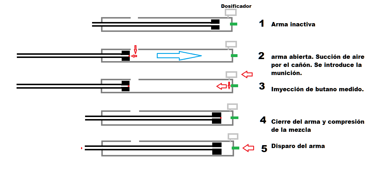

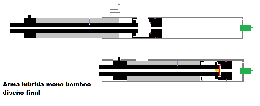

Here, chewing on a single-pump hybrid weapon, but this time, long, to fire pellets.
It would be necessary to use considerable force, about 45 to 50 kg to compress this device. Of course, I have to use my body weight, and the weapon resting on the ground. I would have a device at the tip of the barrel, so that it does not hurt itself against the ground.
Otherwise, the .22 pellet is associated with the rupture disk, and the system is as in the drawing.
The compression pressure of the mixture, (air and butane), is 10X. The dispenser is of the manometric type, in this case, and for a change, since the butane must be injected into the explosion chamber, before compressing the device.

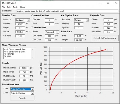

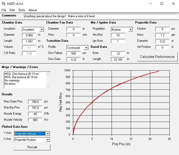

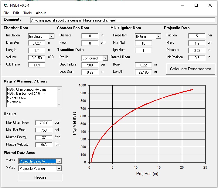

I am including a couple of simulations made by Jack, on this weapon. In one case, the combustion chamber works with 180 cm3 of air and in the other, with 150 cm3 of air.
