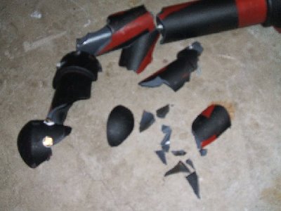

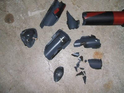

In my opinion, PVC hybrids are pretty much time bombs, just waiting to go off. This was about the 30th shot, and only at a 2x mixture, but apparently it was too much for the pipe. My friend and I believe that from the stress of the PVC expanding and contracting just a tiny bit, the pipe couldn't take it after a while and blew up. I will never make a PVC hybrid again, and I don't encourage anyone else to either. If you really want the massive power of a hybrid, spend a couple more (literally, not much more) bucks and make from steel, so you can go to extreme mixes without worrying about explosion of the cannon.
http://www.spudfiles.com/spudtech_archi ... php?t=6095
FuzzyScorpion's hybrid blew up at a low mixture, for no apparent reason. It was all Sch 80 PVC.
Lucky13's hybrid blew up as well. It had a couple of Sch 40 fittings, but the pressure generated still should have been under the failure pressure of the parts.
It's just an added safety measure. Use steel or iron for a chamber, and you don't have to worry about any kind of explosion (except the one inside the chamber, duh). It's about the same price as Sch 80 PVC anyway, if not cheaper. You also don't have to worry about faulty solvent welds; just use about 1 foot of teflon tape for every fitting 1/2" or smaller, and silicone sealant for anything larger.
If you do make a PVC hybrid, I wouldn't advise using it at more than a 1.5x mixture for it's whole life span.

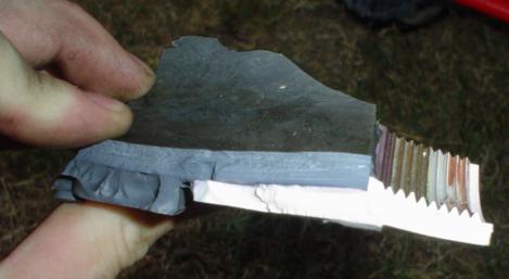

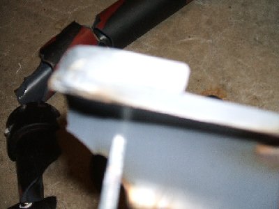

Thickness of failed parts.

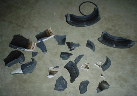

Pieces of my hybrid.

Oh, man, that sucks. How far away were you when it blew?

Around 3 feet. I was standing next to the barrel though, just in front of the union. I was wondering why nothing left the barrel, and when I looked behind me the back had blown off and there were pieces all over.
