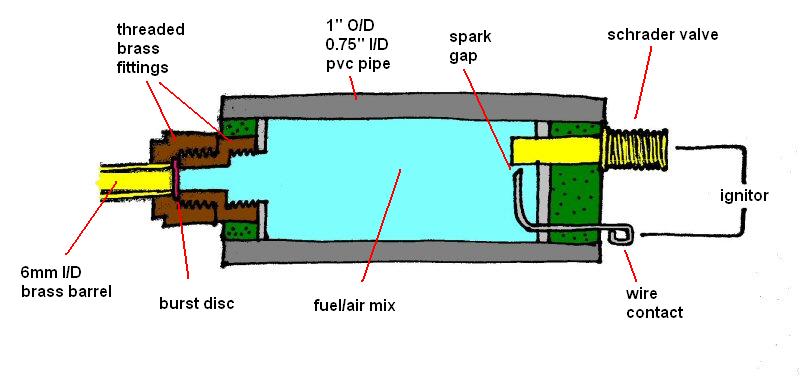

As hybrids aren't really my thing, thought I'd run this by the board first - any reason why this design shouldn't work? Any tips and advice appreciated :)

Looks good to me but wouldn't it be hard fueling it since its such a small chamber?

FeLeX wrote:Looks good to me but wouldn't it be hard fueling it since its such a small chamber?
I suppose this will work well enough:
especially with a shrader valve. when you disconnect some air will leak out, messing with your mix. i don't know hybrids either, but i thought i would just point that out.

Wed Sep 05, 2007 11:05 pm
Hmm I guess. You would have to make an adapter wouldn't you?
Wed Sep 05, 2007 11:13 pm
homedepotpro wrote:when you disconnect some air will leak out, messing with your mix.
Not in my case - I added o-rings to my shock pump so when you thread it onto the schrader, it doesn't actually open the stem, the air leaks in thanks to the pressure difference.
I was thinking of injecting through the barrel end just as you would with a combustion, closing it quickly with the burst disc then bringing it up to pressure with the schrader.
This isn't the first time I've tried something like this, here's a similar previous effort on spudtech, I just thought I'd give it another go.

Wed Sep 05, 2007 11:39 pm
what about a pure oxy mix, then he could just use a pressure gauge
Wed Sep 05, 2007 11:45 pm
Not too keen on using oxygen at this point.

Thu Sep 06, 2007 1:34 am
it looks great jack
i love the spark gap means less hole sin your chamber
oh and making a adapter to the schradar valve shouldn't be hard.
good luck with it jack cant wait to see it

Thu Sep 06, 2007 2:26 am
Hey,
I like your use of BRASS for a barrel. Finally someone saw the light :) Brass is as easy to machine and to braze as copper, it weighs a little less and it is much harder and stiffer.
Aluminum would be nice too, but there is the problem of joining it to other things; either you need fancy welding equipment, or you have to take chances with glue.
Regards
Soren
Thu Sep 06, 2007 2:32 am
I always use brass for airsoft barrels but aluminium would actually be a better idea for the hypothetical cartridge body, a lighter cartridge will lessen stresses on the breech mechanism and be less likely to damage itself when it hits the ground. I don't believe I'd be "taking my chances" with glue, it's pretty strong stuff.

Thu Sep 06, 2007 2:51 pm
jackssmirkingrevenge wrote:Not too keen on using oxygen at this point.
why not?

Thu Sep 06, 2007 3:05 pm
why not?
Probably because of the dangers of autoignition and/or detonation that they pose.

Thu Sep 06, 2007 3:20 pm
What mix will you take it to? And I like the way you use the schrader as part of the ignitor, ingenuity at work.
