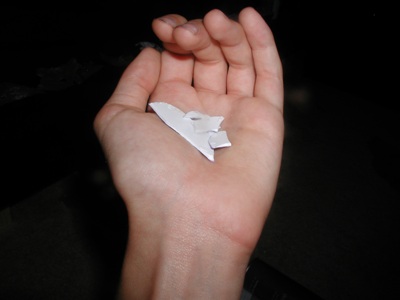

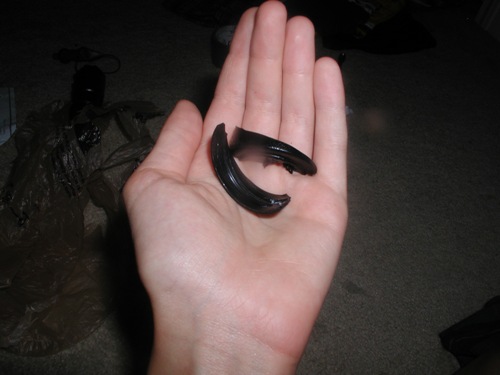

well here is the story.After conducting at least ten 3x in my hybrid at least seven times i was totally sure it was safe at 2x and it propbaly was.Anyhow i was walking to where i was going to test fire it and i dropped it but i didn't think sch 40 would crack only pumped at 2x but i still inspected it to be sure nothing visible so i fired it...
And boom!! this is all i could find of it so far its a miracle i didnt get hurt but i did se a large chunk fly off so possibly i fired it at something higher than 2x who knows.Ohh the shards are from the back of the gauge that hit my house.

welll i found more shards in the bushes...
shards,but i dont know what part of the gun they came from.

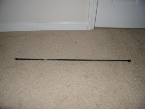

thespeedycicada
Posts: 429
Joined: Sun Aug 12, 2007 1:28 am
Mon Oct 01, 2007 6:45 pm
woot i found the barrel in the woods quite a distance away :D
thats the barrel thank godness i can salvage it!

And speedycicada, those white PVC fragments look awfully thin.
