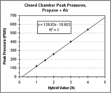

Killjoy's numbers look pretty close. They are off a bit but more than accurate enough for spuding.
The numbers are the GasEq calculated peak pressures for propane+air in a closed chamber. The actual peak pressure in a spudgun will be a lot less, perhpas half the closed chamber values, since the projectile starts to move well before the peak pressure is reached.
Here are the first few numbers I get from GasEq (intial temp 80F, P=1 ATM)
For every integer increase in "X" the closed chamber peak pressure goes up by 140 PSIG.
Code: Select all
Peak Pressure Peak Pressure
X (ATMa) (PSIG)
1X 9.3 122
1.5X 14.0 191
2X 18.7 260
3X 28.3 401
4X 37.8 541
- hybrid_peakP.gif (24.29 KiB) Viewed 3716 times
