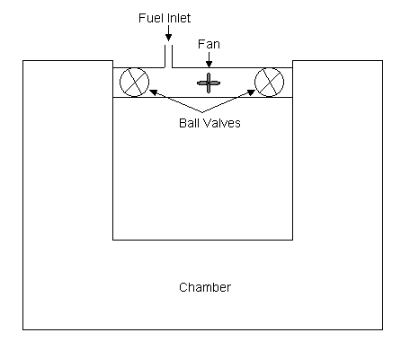

Another way to mix the fuel. Instead of a recirc pump that is run after the fuel and air are injected, use a fan and inject the fuel as the air in the chamber is being circulated. (see attached gif)
1. open ball valves
2. pressurize the chamber with air
3. turn on fan
4. slowly inject propane into the flowing air stream
5. turn off fan and close ball valves
6. fire
The fan should be sized so that it moves the chambers volume in a reasonable length of time. For a chamber volume of Xft<sup>3</sup> a fan that moves 0.1X to perhaps X cfm would seem to be about right. The propane injection time is just the calculated length of time it takes the fan to move the chamber's volume of air. (Of course, it might be a good idea to continue running the fan for a while after fuel injection is complete to insure complete mixing.)
Since the ball valves are closed during firing, the fan is not subjected to the combustion process. Any old fan that doesn't generate sparks should be useable. Perhaps several brushless CPU or computer case fans.
Alternate design: Omit the ball valves. If the barrel is attached at the bottom of the U in the drawing then the gas flow during combustion and firing at the location of the fan is pretty close to zero. The fan shouldn't have any problem surviving.
This also suggests that a toroidal (donut shaped) chamber might be worth considering. Circulation of the gases around the loop can be used for mixing. During firing, there will be a place in the toroid where there are pressure fluctuations but very little gas flow. This would be the spot to install fragile components like a mixing fan.

- Fuel mixer for a large combustion gun
- fuel_mixer.gif (3.71 KiB) Viewed 5478 times

Well, I don't know that it's out per se, as much as impractical. Remember, I'm talking about a 30" diameter chamber that's 50' long. Admitedly it's over kill and I'm seriously considering chopping 20' off of it to reduce the chances of DDT, but the point is that it's a physically large system. A little 4" fan isn't going to do much in there. Too, going with a system like that would open me to a LOT of scrutiny from the safety department folks (live electrical circuits in an explosive environment attracts those guys like naked women attract teenage boys).jimmy101 wrote:So, a chamber fan is definetely out? Some wild ass ideas for mixing.
I've thought about this but it gets back to either a requirement for energized electrical systems in an explosive enviroment or complex seals and such. One *possible* exception would to make this the fuel/air injection point. IE, to set up the tube as an eductor. Of course, the pumping action would stop when the filling stopped, but it WOULD force a significant circulation.2. Add a fitting (with valves) on each end of the chamber. Connect the fittings with hose and a small low pressure, high volume, air pump.
It *could* be done using an aluminum "window" in the chamber, but you have to wonder how effective a small system would be and how expensive a large system would be.3. Metal chamber so a magneticly linked fan / stirring is out... Too bad, a standard chemistry laboratory magnetic stirrer and a 1" long teflon coated magnet can be gotten spinning at a pretty good clip, but only though a plastic or glass container.

I was thinking steel. I like a *big* margin of safety.DYI wrote:As long as this is done in small diameters at reasonably low mixes (i.e. below 20x or so), using SCH 80 is complete overkill, and unneccesarily expensive. Now, you might be talking about PVC, but using any PVC parts in a hybrid isn't a very good idea at all.
Besides that, what do you think of the idea?

Ya, a single fan isn't going to do squat, but a fan every 10 feet might do the trick....it's a physically large system. A little 4" fan isn't going to do much in there. Too, going with a system like that would open me to a LOT of scrutiny from the safety department folks (live electrical circuits in an explosive environment attracts those guys like naked women attract teenage boys).
To get around the explosion hazard you just have to show that there is no ignition source. A generic electric motor is a huge ignition hazard (even though spudders have never been able to ignite propane + air with one). A brushless fan motor running at 12V is not. Live electrical circuits are used regularly in environments that are potentially explosive. Walk into any chemical storage facility; there are light switches, lights and sometimes circulation/exhaust fans. All those devices can be "safed" in terms of sparking and used in an explosive environment.
Another possiblity would be an air driven fan system. A lot more complex that electric fans but zero chance of sparking in the chamber.
Any idea how long it would take for fuel to diffuse the length of the chamber? My WAG is that it'll take a lot more than an hour, indeed it might take weeks.
