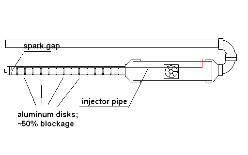

I was thinking of something more like this. I don't see how DR's design would have helped a whole lot.
This would be made from abs by the way. I don't think I would trust anything brittle such as pvc, since this is essentially pushing the flame front towards DDT conditions. I doubt propane/air would create a transition in a small scale such as this, but who knows?
- The injector pipe has tiny holes down the length of it for even fuel distribution.
- accelerator.GIF (4.36 KiB) Viewed 3323 times
@_Fnord
That might work BUT
In the "runup pipe" the flame front is slow and slowly increases pressure over the whole chamber.
When the chamber finally ignites (quickly) the pressure raises not at much as normal due to the volume in the runup pipe.
The "runup pipe" should be small diameter since this will reduce the volume of it.
That might work BUT
