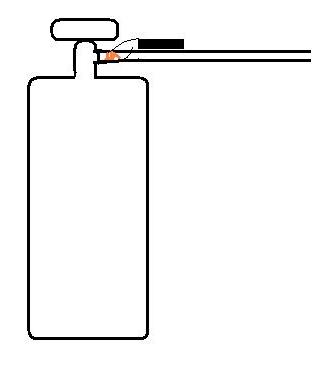

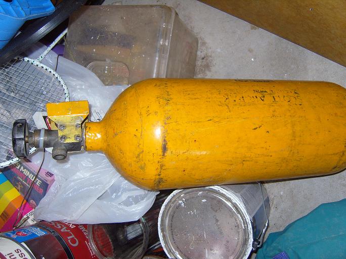

My friend gave some air tanks from the fire department. Every few years they have to get new ones. their operating pressure is 2000 psi. my other friend thought of a new design for a hybrid that I wanted to see what you think of it.
The fuel and air is pre mixed in the chamber. there is a constant spark in the barrel close to the chamber. as the mix is coming out of the chamber it ignites. could this work?

here are the pics

The design has a lot of flaws. If you have a continuous spark the chamber wouldn't fill up with fuel before firing. You need a timed spark so that it would fire just as the tank filled with new fuel. Also this couldn't work as a hybrid. From what I can see there is no valving of any type in the design. This design would not be very efficient either. The gap needs to be in the chamber to gat a nice combustion. It seems what your going for is like a puslejet engine. But if there is a valve that you may have forgotten to put in the illustration then I guess it could work as long as the valve closes after each firing. If I got those tanks I would make myself a nice air system for a pneumatic... If you ask me though.

Perhaps if you put a read valve separating the tank and barrel. It would have to work like a pulse jet engine. As RC mentioned.
The moment you try and introduce more gas into the chamber it would force the BB out...
