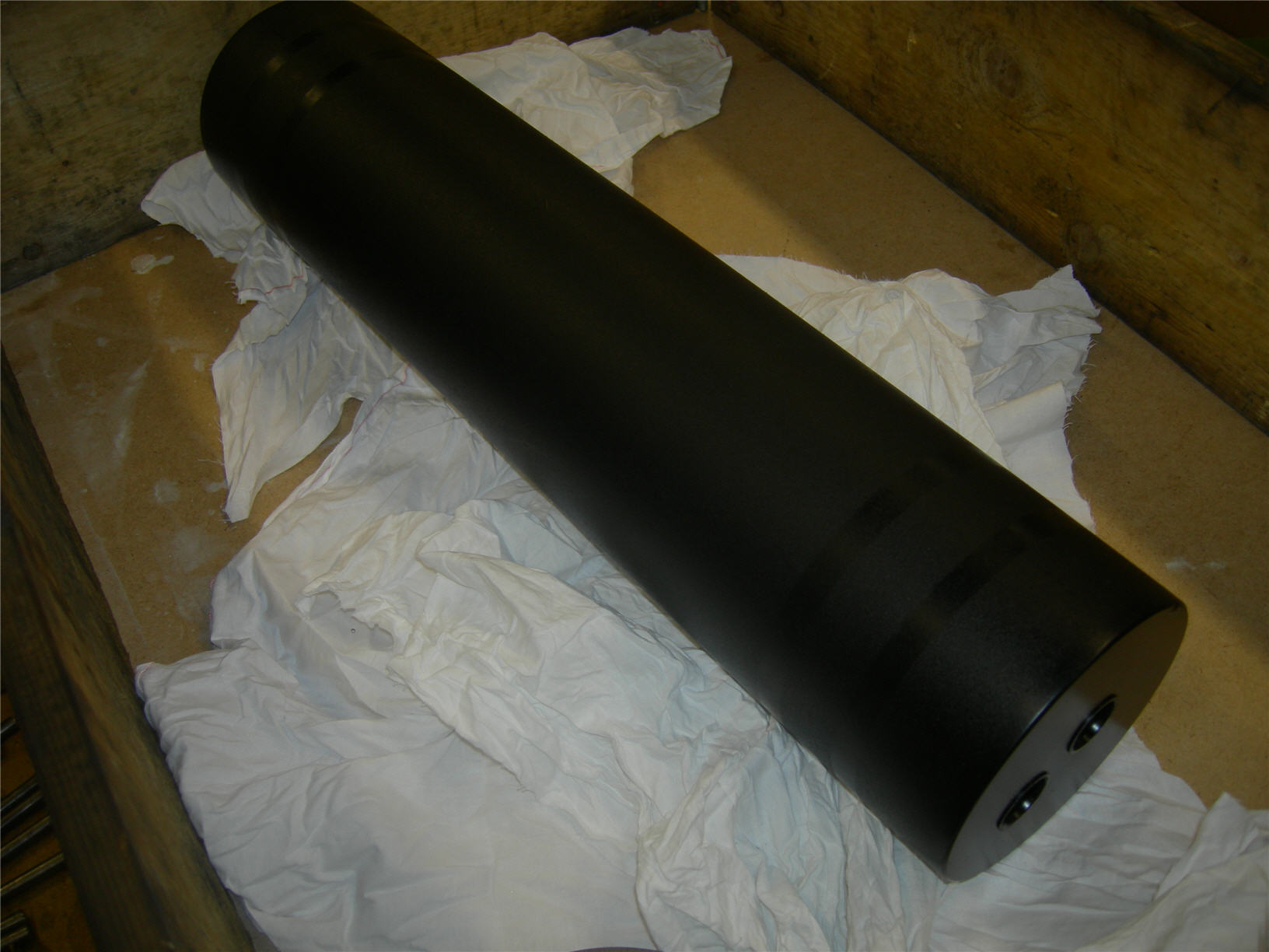

if your worried about it, then use a spark strip of 2 gaps, dont even need to drill another hole.
with a higher mix, more fuel combusts at once, creating a denser/ faster shock wave
EDIT: yes,your fine with 3.

Amen.MrCrowley wrote:Not a chance i'd say. As you know DDT prefers long, thin chambers. 24" of 5" pipe should be fine at 11x.
Amen.rp181 wrote:if your worried about it, then use a spark strip of 2 gaps, dont even need to drill another hole.

Ok, I realize the topic is a little dead, but I thought I might impart a little of my DDT knowledge. DDT is more likely to happen at higher pressures, due to the fact that there are more little fuel and oxidizer molecules bouncing into each other. It also prefers longer, rougher run up distances. The shorter and smoother (causes less turbulence) your barrel the better your chances of survival. Also multiple spark gaps should do their job of preventing long run up distances.

ok. i just realized that with 3gaps at 11x there would have to be one heck of an ignition.. i am going to make two gaps. one back and one almost at the barrel side.

Come to think of it, what kind of ignition device are you using anyway? You're going to need some impressive voltage here. Are you just ordering a stungun from BCARMS, or making a camera cap system? If you are, you're going to need REALLY short gaps.
