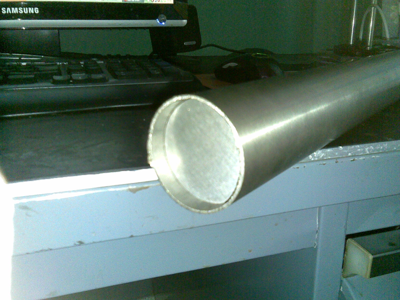

I am using a 50 mm OD stainless steel pipe with a wall thickness of 1 mm.. (ID is 48 ).. How high of a mix can I go with it?

picture will help a lot.

This is the pipe.. with an endcap in it.

Necrosis, you need to research the strenth of the pipe you want to use, specs from the manufacture would be best. Sounds like you should also do some research on the fuel you want to use. Maby you shouldn't even try this because you admittingly don't know what your doing. Don't want to hurt yourself by making advoidable mistakes.

Necrosis wrote:I am using a 50 mm OD stainless steel pipe with a wall thickness of 1 mm.. (ID is 48 ).. How high of a mix can I go with it?
Thanks in advance.
ROUGHLY speaking.....
Figure with stainless you've got a yield stress of 60 ksi (could be more, but since we don't know what you've got that's the number I'm rolling with).
Yield = ID*Pressure / (2*WallThickness)
2 * WallThickness * Yield / ID = Pressure
= 2 * .0787 * 60e3 / 1.890 = 5,000 psi.
But that's FAILURE. That is not what's SAFE to work with.
For safety, divide by 5-10 (depending on how safe you like to be).
So I'd say you're good for 500-1000 psi.
Note: That also assumes we're talking about seamless tubing. If there are welds, I'd split it in half. Call it 250-500 psi.

remember it is hydraulic tube like that with walls just a little thicker so i think you are good.
to answer your question i would have sticked to 6x

Safety factors also depend on the consequences of failure; i.e. if you're planning on igniting it from 100 yards away behind a foot of steel, you probably don't need a safety factor of 10. If you plan on actually holding it in your hands... Then a factor of at least 5, preferably more, should be incorporated.

get 2 more end caps, and a 4 inch or longer section and destructively test it.
no way else to be sure

I'll get some real good pipe on saturday.. that's been rated for 300-600 bar (depending on what's lying around).
