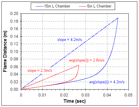

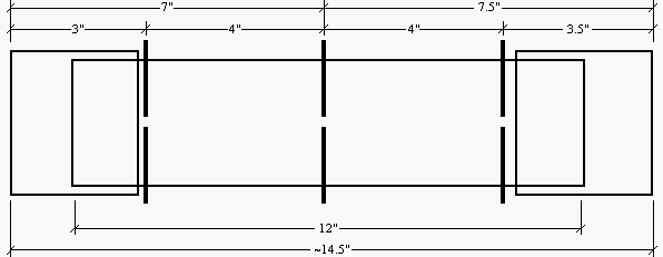

I think there is a problem with the way you calculated the average flame speed. And, I know there is a problem with the dimensions of the gun. The image on my page is accurate, though somewhat misleading when it comes to the dimensions.
Below is a better-dimensioned drawing. The chamber is roughly 15" long, not 12" (the 3" pipe is 12" but you need to add the length of the fittings), and the spark gaps aren't perfectly spaced (I wanted to avoid the end of the fittings and the fan etc.). Even the dimensions shown in the drawing below aren't perfect since the threaded plugs, reducers etc. make it difficult to exactly define the length of the chamber. From the <a href="http://www.inpharmix.com/jps/Chamber_Te ... ">acoustic temperature study</a> I got an effective chamber length of 14.7".
I believe the average flame speed should be calculated as the maximum distance the flame front has to travel divided by the time to burnout. I don't think the function you used is correct. Is the sqrt(6^2+1.5^2) supposed to be the "RMS" distance? Shouldn't there be another factor of 1/2 in there? In any case, the chamber has not yet burned out when the flame front has propagated the "RMS" distance. Using (max distance)/(burnout time), I get;
Shot 8 (single central spark):
Flame must travel the maximum distance to end of chamber = 7.5"
Time to burnout = 53.9mS
=> "Average" flame speed = 7.5"/0.0539S = 11.6FPS = 3.5m/s
Shot 11 (three sparks):
Flame must travel the maximum distance to end of chamber = 3.5" (right hand gap to the end of the adaptor)
Time to burnout = 39.4mS
=> "Average" flame speed = 3.5"/0.0394S = 7.4FPS = 2.3m/s
So, the "average" flame speed is greater than S<sub>L0</sub>~0.4m/s for both configurations.

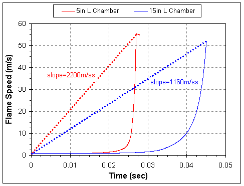

I used my combustion model to compare the flame position and speed for two closed chambers. One chamber is 15" long and the other 5" long. The 5" L chamber is a crude estimate of the behavior of a 15"L chamber with three spark gaps. I've attached graphs of the flame speed and position as a function of time.
The "average" and the "instantaneous average" flame speeds are predicted to be slower for the smaller chamber even though the smaller chamber burns out sooner than the larger chamber. The "average" flame speed are similar to the experimental numbers; one spark (blue line) ~4.2m/s, "three spark" (red line) 2.3m/s.
In the second graph, the maximum flame speeds are nearly identical for the two chambers, which is to be expected. But, the smaller chamber has an "average" flame front acceleration of about twice the larger chamber.
The burnout times are similar between my model and my data. One spark in a 15" chamber; calc. burnout at 45mS, measured burnout 54mS. Three spark burnout (calc as a chamber of 1/3 length with a single spark) 27mS, measured for 3 sparks in 15: chamber 39mS. The agreement isn't exactly spectacular but, given the complexity of the combustion dynamics, I think it is pretty good.
The graphs can be a bit misleading, you have to be careful about how you interpret them. Looking at the flame speed versus time graph you might think that the high flame speed is highly significant. In actuallity, you probably need to look at flame speed versus fraction of the fuel burned to get a better idea of what is going on. (Or perhaps energy released per unit time.) How much of the fuel was actually burned at the very high flame speed? The low flame speed region lasts a long time but how much of the fuel was actually burned in that time period?

Ah. Thanks.jimmy101 wrote: The chamber is roughly 15" long, not 12" (the 3" pipe is 12" but you need to add the length of the fittings), and the spark gaps aren't perfectly spaced (I wanted to avoid the end of the fittings and the fan etc.).
AgreeI believe the average flame speed should be calculated as the maximum distance the flame front has to travel divided by the time to burnout.
No, that's not RMS distance. It's the max distance the flame has to travel in a 12x3 chamber with mid-point ignition. IE, the flame must travel 6" up/down the chamber and 1.5" up (ie, to the wall of the chamber).I don't think the function you used is correct. Is the sqrt(6^2+1.5^2) supposed to be the "RMS" distance?
So using your 15" length I now get....
Shot 8:
sqrt(7.5^2+1.5^2) = 7.65"
Time = 0.0539
=> 141.9 in/s = 3.60 m/s.
Shot 11:
sqrt(3.5^2+1.5^2) = 3.808"
Time = 0.0394 s
=> 96.64 in/s = 2.45 m/s.
Agree. Ah, what a difference a couple inches in chamber length make.So, the "average" flame speed is greater than S<sub>L0</sub>~0.4m/s for both configurations.

More musings....
If one has a planar flame front and a constant velocity flame, then one would expect the pressure increase in the chamber to follow a second order curve with respect to time....
Fuel burns. Pressure increases. As pressure increases, density increases. With increased density, a flame that burns X fps burns an increased amount of fuel per unit time. Repeat cycle.
If the flame front accelerates (as everybody agrees that it does) then similar things happen but everybody gets to add one (or more!) to the exponent. If the acceleration is linear, the flame speed is 2nd order, and the pressure trace becomes cubic (3rd order).
If the flame front accelerates as a second order? Hey, now our pressure trace is 4th order.
The only problem with all this is that our flame fronts are NOT planar. They start out roughly spherical and evolve from there.
Still... Do we have any *measured* pressure traces to look at?

The gas density doesn't change during the combustion process in a closed chamber. There may be a density gradient but the total mass/volume is a constant. In a gun, the density decreases once the ammo starts to move.D_Hall wrote:Fuel burns. Pressure increases. As pressure increases, density increases. With increased density, a flame that burns X fps burns an increased amount of fuel per unit time. Repeat cycle.
So, shouldn't it be;
Fuel burns
Temp increases
Pressure increases (because of temp increase and the very small affect of more moles of gas if you're talking about propane combustion)
Using; S<sub>max</sub> = S<sub>L0</sub> (P<sub>max</sub>/P<sub>0</sub>)<sup>beta</sup>(T<sub>max</sub>/T<sub>0</sub>)<sup>alpha</sup>
The increased pressure slows down the flame speed by small amount (beta=-0.17).
The increased temperature greatly increases the flame speed (alpha=2.13)
Things progress in this way for a while until something triggers turbulent flow. Could be caused by the combustion process itself, or by movement of the ammo.
Turbulent flow gives a turbulent flame front and the flame speed of a turbulent front "can be up to ten times faster than" than a laminar front. (from a paper I read long time ago, I'll see if I can dig it up).
You can use the adiabatic combustion temp to estimate the maximum laminar flame speed in a closed chamber.
For propane in air;
alpha= 2.13
beta= -0.17
P<sub>max</sub>= 9.28 atm
T<sub>max</sub>= 2631 K
P<sub>0</sub>= 1 atm
T<sub>0</sub>= 300K
S<sub>L0</sub>= ~0.4m/s
(Pmax and Tmax from GasEq for adiabatic propane + air).
S<sub>max</sub> = (0.4m/s) (9.28/1)<sup>-0.17</sup>(2631/300)<sup>2.13</sup>
S<sub>max</sub> = 30.4m/s
10X for the maximum affect of turbulence gives 300m/s. That is near the speed of sound at 300K, but is only Mach ~0.3 at the 2600K temperature in the chamber.

Ya, I get that the fuel consumption rate changes if the unburned fuel is compressed by unburned fuel. If the unburned fuel is compressed by combustion products (density increases because of hot N2, CO2 and water ejected from the combusted volume) that won't necisarily increase the burn speed, at least not because of changes in density. The big change in the temperature would be expected to be much more important than the smaller change in density (or pressure).
Increasing the pressure of the unburned fuel slows down the flame front slightly. I don't know how to equate the slightly slower flame velocity with the increased fuel density to get at the net affect on moles fuel burned per unit time. The mass burn rate might go up or down.
the flame speed increases continually with the square root of the time
Only problem is that you don't know what the proportionality constant is. And, is the constant the same for all chamber sizes and geometries or does the constant change with the chamber volume and dimensions?
The relationship might break down if you get to DDT conditions but those conditions are difficult to reach and require that several factors are in perfect balance.
