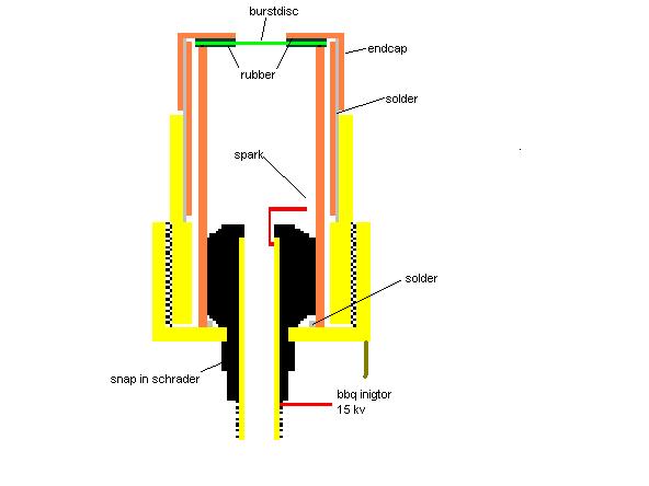

hi
thx for answer
i see you are positiv abaut nicro hybrid
in my head are many questions....
i will pump in the fuel/air mix in the chamber with a
syringe/homemade-pump and i don´t know
how much heat will enter my mix by compression
(up to 20 bar in one pumpstroke!). self inigtion like a diesel carmotor?!
scary or not?
what do you think about electrostatics? many friction come when stroke the pump!
scary or not?
inigtion....16kv bbq inigtor....?
hgdt say 200bar maximal chamberpressure by combustion a 25x mix. what is with ddt in a 1-5ccm chamber and how high can the pressure go?
a picture... first prototype cartridge
thx for answer
scary or not?
scary or not?
- first proto to test burstdisc materials, inigtion, fuelmix...
- proto.JPG (18.84 KiB) Viewed 4169 times

hi
first a link http://www.kupfer-institut.de/front_fra ... ai2006.pdf
site 15/16 show the workingpressure of copper tubes
site 16 show a picture of bursting 22mm copper tube at 280 bar
mh bigger is better yeah i know but its time for hybrid plinker;) hope for help.
in the end my dream is an small hybrid plinker, fast ready to shoot (piston valve like _fnord?), and power like 10-15 ftlbs.
