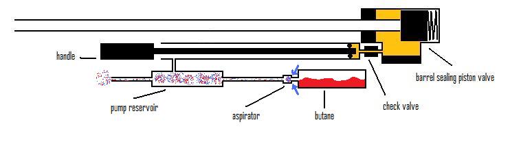

Below is the layout that came to mind initially. Breech could be blow forward or attached to the handle. Depending on the size of the chamber and rams, and what mix you were going for, you could either pump once or multiple times.
Doh! Just realized you would need another check valve to be able to move the rams to the left.
I think this idea has the potential to make a compact, high capacity cannon, because you only have to carry the fuel like a combustion, but with the power of a hybrid.

ramses
Posts: 1679
Sun Feb 22, 2009 8:45 pm
not really; you could pull vacuum until you get to an equalization hole like rag on his shock pump.
easier to use a check valve, but more dead space (unless you use a floating o-ring)

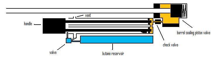

The equalization hole gives me an idea, see diagram. This would allow you to pump constantly instead of waiting for the fuel to flow through the pump, because the reservoir would fill on the compression stroke.
I should probably search more, I just came across your thread from a few months ago on a semi combustion, as well as a bunch of earlier discussion :oops:.

Ragnarok
Posts: 5401
Location: The UK
Mon Feb 23, 2009 5:13 am
You're misunderstanding. The whole point of dieseling is that it's compressed very quickly - because the compression generates heat, which then provides the energy needed for ignition.
Propane won't just ignite when it hits 15x - take Larda's 200x hybrid into account here. You have to take the mix, then if compressed sufficently rapidly (i.e. over the course of milliseconds), auto ignition with propane will occur at somewhere between 17:1 and 20:1 compression. (In other words, it's gas density would be that of a 17-20x cannon on ignition)
At this point, the pressure (because of the heat rise) is around 42 atmospheres - hybrid mix is measured not by pressure, but by gas density (some people use fuel density)
After dieseling, the pressure will spike to around 180 atmospheres (~2600 psi) - about what you'd get from a 25-30x mix normally - all of the extra coming from the increased burn efficiency and pre-compression temperature.
You'll lose a lot of this again unless you can keep the piston that compressed the mix from recoiling again under the pressure. Really, you need a very heavy piston that's fired forwards by a high power pneumatic to compress the hybrid fuel, then hope it's mass stops the piston from recoiling back too quickly.
Basically, build a light gas gun with a hybrid mix in the compression side, and use a pneumatic to power the compression piston.
ramses
Posts: 1679
Mon Feb 23, 2009 8:59 pm
That seems logical, but I think he wants to avoid dieseling, rather than cause it.
...I just don't want it to autoignite prematurely.
