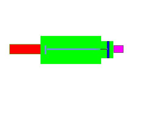

Crowleys hybrid got me thinking about this again....
How abour a larger version of fnords piston hybrid, except make it a toolie style chamber/valve...
by using high pressure 300-400psi popoffs as the pilot for the piston you could effectively have a controllable high psi release valve for the chamber....
Maybe I'll go Hybrid with my steel gun....

That's brilliant.except make it a toolie style chamber/valve...
Maybe not for practicality, but for power-to weight ratio.
I never gave much thought to that valve style, but I bet it would work well.
If it's ok with you I might actually try a hybrid with a toolie valve eventually, but I think it'll need a lot of tweaking to get it functioning correctly.
The pop-off won't necessarily make it controllable, that depends largely on the valve dimensions. (I can't seem to see why everyone insists on pop-offs...)
To clarify for me, Doesn't the popoff act as the pilot release for the piston that sets the piston actuation pressure, or is it just a safety precaution?
And since we are talking combustion/hybrid having more than the normal opening distance(for a pneumatic) for the piston I think would be in order...

A pop-off IMO will never be a safety feature because your chamber should already be able to contain the blast without damage. If it can't, I wouldn't use it.
The opening pressure normally depends on the difference between the seat diameter and the piston diameter (or in the toolie valve, the "disk" diameter).
If the pop-off is rated to a lower pressure than this, the valve will open at the lower pressure. If the pop-off is rated to a higher pressure, the valve will still open, but the pop-off won't do anything.
Obviously, the opening pressure also depends on the mix pressure you use.
A high-opening pressure valve should have a seat diameter that is 80-90% of the piston diameter. This presents a flow problem in a toolie valve(sealing face diameter is too big for gas to flow around!), but that can be corrected by reducing the overall valve diameters. Sleeve some smaller pipe inside the chamber for the disk(back) to rest in, then reduce the porting diameter appropriately.
Clear as mud?

I get it, the popoff is more or less to keep the pilot volume from becoming a pneumatic spring....
As far as sealing face and disc size ratio, one could make a chamber similar to this diagram relatively easy, and not have to do a bunch of sleeving...
- red is barrel, green is chamber, blue is toolie valve, and pink is pilot port...
- hybrid toolie.jpg (7.57 KiB) Viewed 4095 times
