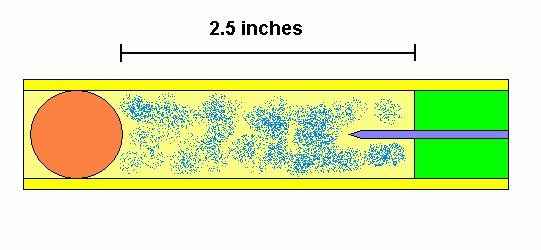

As per title, does anyone have any solid data on such an oxygen+fuel mixture in small launchers? All the search feature seems to turn up is warnings not to do it :roll:
edit: In a nutshell (or should that be brass :roll: :D ), the idea is to have such a system in a small 6mm cartridge like so:

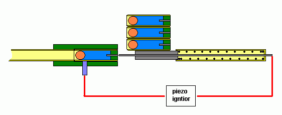

...which would be fired from a semi-automatic action with a piezo ignitor, like so:
Worthwhile power, what does the board think?

I'm not thinking massive quantities, say a 5x mix in a cartridge similar to the one illustrated for a 6mm projectile.
Both oxygen and butane - the fuel I intend to use - are heavier than air so I'm guess it could be fuelled with a syringe.
With those dimensions by my calculations I would need to add roughly 0.4cm<sup>3</sup> of butane and 1.4cm<sup>3</sup> of oxygen.

The idea is to be able to make a small calibre shell-ejecting launcher with "realistically" sized brass cartridges that can fire semi-automatically, with enough power to eject a spent cartridge (by means of an angled bolt tube as I did here and drive the bolt far enough to chamber another cartridge.
It should also have worthwhile power, I'd be happy with 400-500 fps for a 1 gram projectile.
This is what I imagine the launcher to look like in basic functioning terms:

If you were very enthusiastic you could use a flyback generator or a marx made with pulse caps for full automatic. Sure, it would give you limited portability and have the slight risk of killing you if you happen to touch the contacts, but full automatic hybrid ejecting shells would be too cool..

Jack, I know you're keen on using the same material for both cartridges and barrel but wouldn't it be more efficient to use short fat cartridges (although harder to make) rather than longer thin ones?
First of all, you'd need less travel in your system to eject and reload, and secondly thinking that the cartidge is likely to be moving back as the projectile is moving forwards, then a short fat cartridge would mean less pressure is needed to propel it backwards. It's a bit like the stepped piston idea in gas repeaters.

inonickname wrote:full automatic hybrid ejecting shells would be too cool..
Too cool and too time consuming to load the cartridges, I'd be happy with semi-auto. It gives you time to appreciate the individual clatter as each cart hits the ground :)
That's the point really - using the barrel material completely eliminates any alignment issues , and makes manufacture much more straightforward.
I agree though that using a fatter cartridge gives you a lot more mechanical advantage when it comes to shell ejection, I found this out while testing my preloaded cartridge prototype (and you pointed it out there as well ;) )
JSR wrote:The main reason I abandoned this design was the lack of power blowing back the cartridge, mostly because the massive (in comparison to the 6mm valve port) 0.75" barrel that didn't allow sufficient pressure buildup. I was aware of this point but SPG brought it up recently and got me thinking again.
I did a small experiment and blocked off the breech with a 6mm aperture to see if it would make a difference. To say that it worked is a bit of an understatement, even without a projectile the thing blew back with such violence into my hand that it turned the tip of my finger purple

JSR,
An easy way to figure if this is plausible is to look at how much energy you have stored in the cartridge. I figure those dimensions (6mm or .22 by 2.5")
will have about .1 ci in each shell.
I believe oxy-butane would give a little less than 20,000 joules per liter, so you have about 30 joules to work with. 20% efficiency would give you 360 fps with a 1 gram projectile.

The performance figures are a bit marginal, maybe a short fat cartridge is inevitable. Let's see, 0.5" I/D an inch long will give me double the volume...
