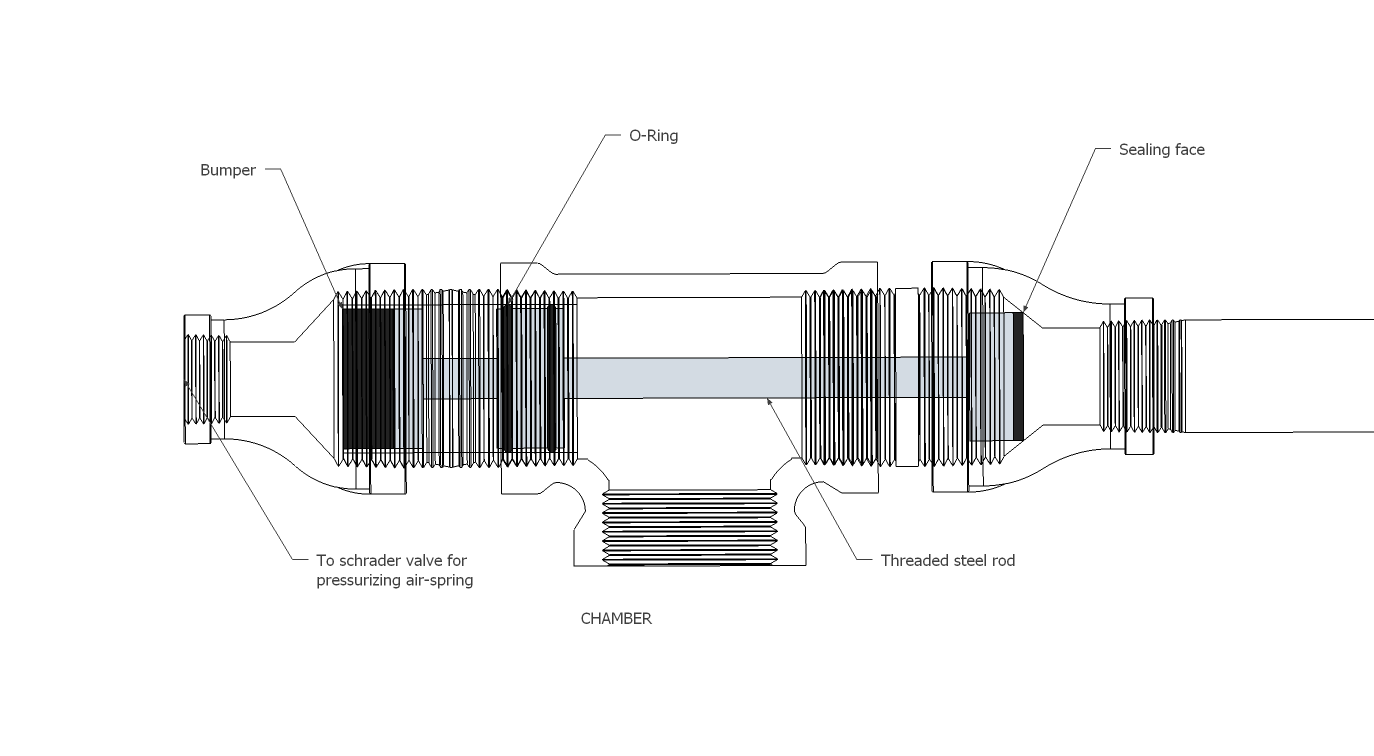

@ Ramses -
I think the porting will be something like 1-1/4" for the 3/4" barrel. I have made up a *very* preliminary design for my valve (looking at it now, I can already see a bunch of improvements I could make), but it should give some idea of what I'm trying to do. As you can see, the piston slides and seals against the 1.25" pipe nipple and is stopped from moving too far by the bumper. I do not plan on bringing the barrel into the chamber at all like in many pneumatic valves. I will simply have something that seals against the bushing or coupling to which the barrel attaches.

- I'll update this once I've made some design improvements
- Hybrid Piston Valve.png (36.03 KiB) Viewed 5224 times
so the part of the "spool" that seals the barrel is slightly smaller than the one at the back that seals the "pilot" off. That is a great idea. The back part of the "spool" will need to be longer or the whole piston will have a tendency to "tip" under gravity. You will also need to dramatically decrease deadspace in the pilot area.

You may also consider not using any threaded components. You can make your cannon very clean by using a section of unthreaded pipe and then buying disc shaped material and drilling holes and connecting the caps with full length B7 studs.
