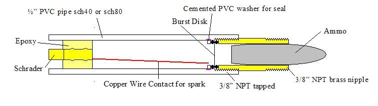

I am dreaming up ideas of making hybrid cartridges that will hopefully be shot semi-automatically. My question is, can I get away with using 1/2" PVC as a cartridge with a 20X mix? I know that sounds crazy, but when the cartridge is fired, it will be housed in 3/4" type M copper receiver then ejected. The burst pressure for sch 40 1/2" PVC is 1,910 psi and for sch 80, 2,720 according to engineering toolbox. If 20x is not plausible then what is the highest safe mix that I could get away with. I would normally find the pressures generated by mixes using HGDT, but it doesn't work on this computer.

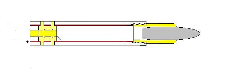

I have three main reasons for using PVC for a hybrid cartridges. The easiest and most compact method for attaching a schrader valve to the back of the cartridge (with insulation for a spark) would most likely be the way daccel did it BACH (epoxy with holes drilled in the cylinder for extra strength. He pressure tested it to 3,300 psi and it didn't fail. I believe the epoxied schrader would be the weakest link so there is no point to using metal if the back end is going to pop out first. Secondly, plastic is lightweight and hopefully that will aid the ejecting process. Lastly, PVC is cheap and easily mass producible.

I would never use PVC in a hybrid no matter what. Just a personal thing. It's up to you, but I wouldn't unless required.
If the diagram is to scale then the burst disk will not have enough force to clamp and seal it there.
PVC Arsenal 17

I know nothing about hybrids and I'm extremely unqualified to make any comments here, but I would at least suggest sleeving the inside of the PVC chamber with copper. PVC may be able to handle the pressure, but the sudden spike in pressure from hybrids is what has caused some to fail. There was a thread on this recently.

I have some suggestions. Consider aluminum tubing. Very strong, especially when small diameter and also very cheap as well. Lose the epoxy in the back and use an aluminum disc with press fit retaining pins to hold it in place. Then tap an NPT hole in the plate and install the schrader.
In the front you could clamp the burst disc with an aluminum half coupling.
You may also simply use aluminum pipe nipples and tap a hole through aluminum plugs.
These are just the first thoughts that came to mind. I would start there and let it evolve to its final destiny. Thats just me though.
Also consider simply making a piston hybrid with easy fueling capabilities. The cartridges don't take any of the loading time or work out of using the cannon. They simply require you to do more work up front to shoot more times later.

I thought about doing this a while ago, You're right abou the 20x mix, you will need at least this to get appreciable power with such a small chamber, or you could go for a smaller oxygen + propane mix number. Also consider having a larger diameter cartridge than projectile, like a real rifle cartridge.
I dont think PVC will be upto the job especially with holes drilled in it for the epoxy plug, plastic is plastic at the end of the day. I would suggest a combination of brass fittings and copper pipe, this way the whole assembly can be soldered/sweated together. The only difficult bit is retaining electrical isolation between the schrader and cartridge for the ignition circuit.

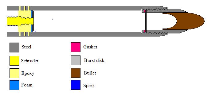

I decided that if I am going through all of the trouble to use PVC for a cartridge it is not worth it. My next design uses a 1/2" sch40 steel chamber and a 3/8" sch40 steel ammo tube. To seal the burst disk in, I would solder a washer down inside the threads to provide a sealing face and stopper. I can make a gasket out of some PVC bath liner I have to ensure a seal against the washer.
As for the spark, I will solder a steel washer to the end of the schrader and epoxy it in so it is not quite touching the inside wall of the chamber.
Here's the new design:
- Attachment hybrid cartridge 2.0.JPG (20.28 KiB) Viewed 5427 times
I would suggest against a sch 40 chamber: do you really trust .06" thread depth to 20x?
If you use 1/2" sch 80, you actually have to drill out the end to get the recommended hole size. Depending on length, you can drill out the whole inside to get a larger ID, maybe even drill out most of the diameter to the sch 40 specifications.

Sorry. I have respect for them and those who build them, I just felt the urge to share my personal opinion which should have probably been withheld, especially in someone elses thread.theBOOM wrote:Moonbogg dont this the minis
This last design looks promising to me, I like the washer spark gap. I second using oxygen if possible, to get more power out of the limited volume.
I think it will be sufficient, maybe even better, to thread the inside of the chamber where the epoxy sits rather than drilling holes in it. And since you're already threading the other end, fabrication requires less tools.
